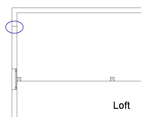

Hi, I haveing a view and my view range makes my roof show cut lines (see attached picture) How can I hide them? /jocke

with lofts and attics, sometimes best to use plan regions near the edges.

Thank you, that helped /Jocke
