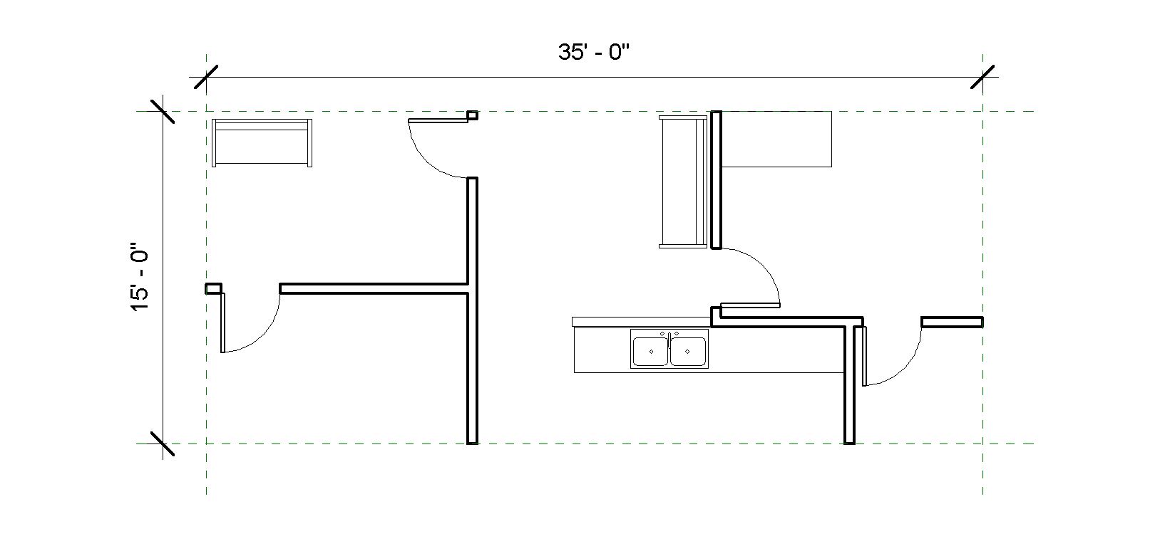

Im using Revit 2017. Since my firm is trying to step into Revit- I have been experimenting possible ways to model and work with repeating building units (in a condo for example). I dont want answers to how to do this in other ways (model groups, etc) since that would be another post. So, while i was trying the units as a seperate file which is linked in- I came across one problem:

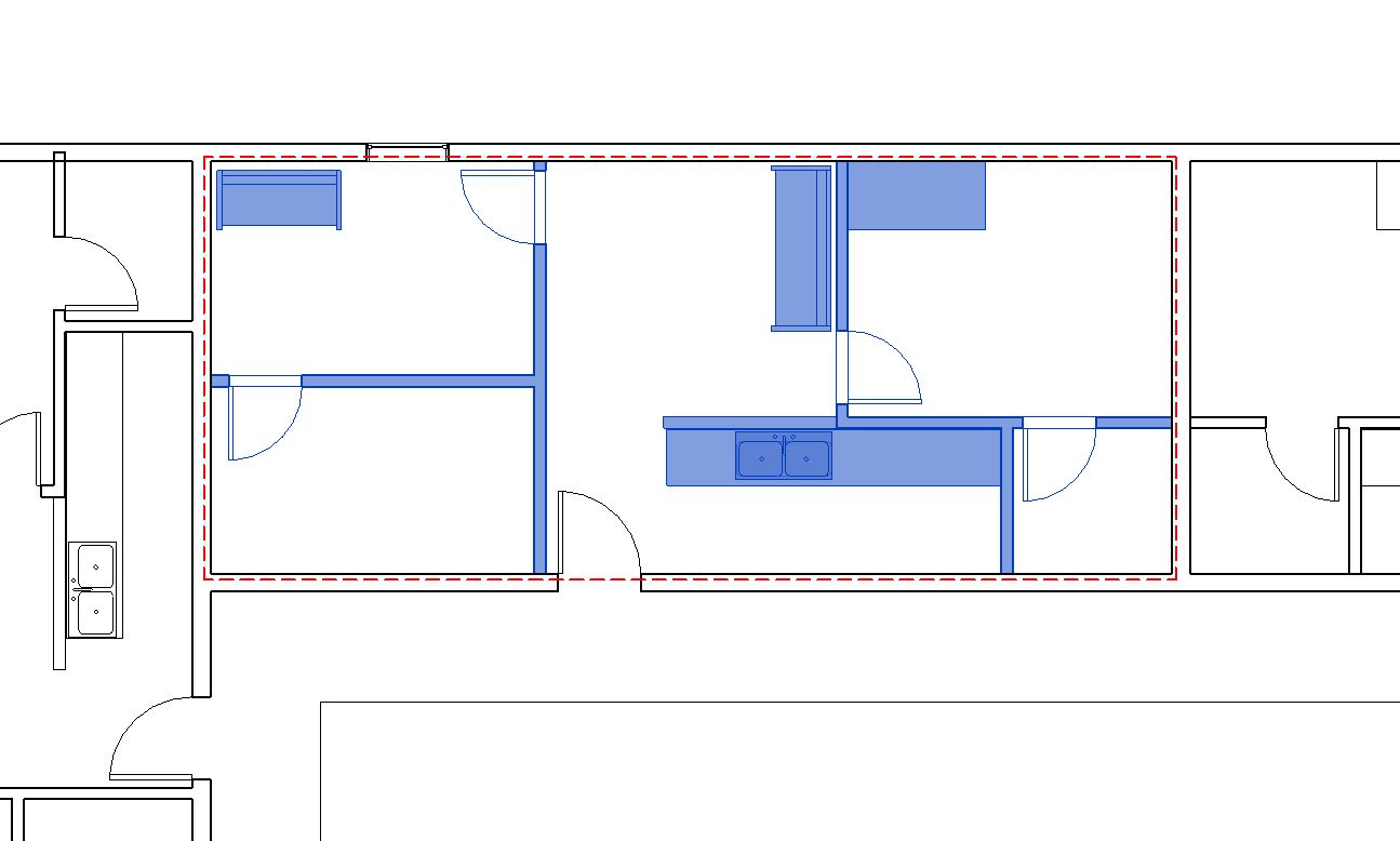

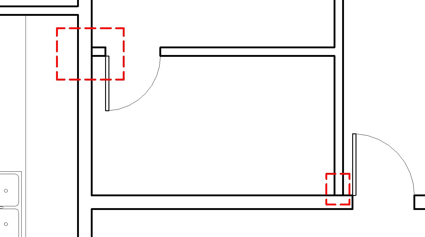

Since the units walls are another file, graphically the wall doesnt 'join' with the exterior walls. Refer images below (sample simple test models). Images show the seperate unit file, and the linked in model and zoomed in wall join.
Is there anythin other way to make the walls appear joined, other than masking regions?

None that I see using your process.
