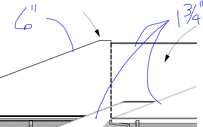

Hi - I'm using roofs that are just the comp shingle and plywood in thinkness, no structure. In elevations I can't seem to eliminate a double line in the roof ridges, that seems to be like the roof is transparent and you see it like a wire frame. I've tried all sorts of transparency settings but nothing affects it. WHen I change to roof to 4" thick, same problem. When I make it 6" thick, the problem goes away. But I really don't want a 6" thick roof. Any suggestions? I'm working with structural eng who is doing revit and I just the plywood to lay on top of the trusses with no structure in the architectural model.
Thanks!

Could be your display, graphic card issue perhaps. I cannot replicate you problem on my system (gtx 1070). Turn hardware acceleration off, see what happen.
Upload your file, I can test it if you want.
