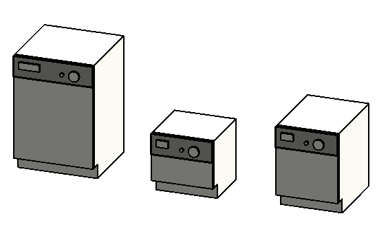

I'm pretty new to Revit but have 20+ years of CAD experence. I'm trying to build a Revit tiny house/RV. I'm having trouble finding appliances to fit a tiny space. I'm not very good at modeling yet so I've been trying to find models but am having issues finding these things. Any help or advice? TIA

Duplicate the existing family type and change the built in parameters. See attached dishwasher example.
