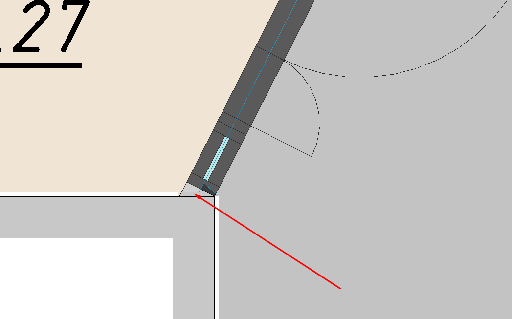

Hello, I saw some threads on how to join 2 curtain walls at an angle. How about creating an angled mullion when the curtain wall joins with solid wall at an angle? Any ideas how to connect them? Thanks in advance.
Tue, Jun 12, 2018 at 7:48:46 AM | Curtain wall to wall at an angle
Do you really want a special extrusion for this mullion?  I doubt it.  We always either tuned the corner with the wall or used a metal closure on the inside.

Thanks. I guess this depends on manufacturer's details and you are probably right about using closure. What do you mean "tuned the corner with the wall"?
Tue, Jun 12, 2018 at 2:38:49 PM | Curtain wall to wall at an angle
I mean we used wood blocking cut in a trapezoid then turned the interior drywall for that short distance.  The outside finish would not have to turn but personally, instead of that, I always tried to have a short stub wall here and I turned both the interior and exterior finishes.  Part of that detailing depended on the interior.  If you have drapes, you need space to store them.
