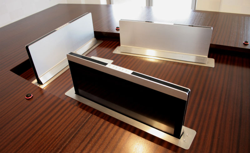

pls i need an rfa for a conference table with automated monitor lift. the kind where the monitor flips in and out of the table and fitted with a flip cover that opens and closes.
something like what's in the photo

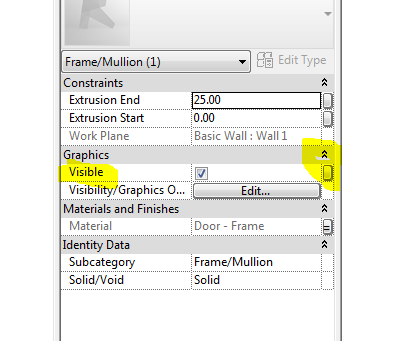

1) Create table
2) Create monitor in park position with cover closed.
3) Create monitor in display position with cover open.
4) Create on/off instance parameter for (2)
5) Create on/off instance parameter for (3)
done
__________I'm the guy they come to when they didn't follow my recommended workflows.__________
Mon, Jun 18, 2018 at 10:44:36 AM | an automated retractable screen table
dgcad
dgcad Avatar
Joined: Thu, Mar 17, 2005
1231 Posts
3.5 Stars: 36 Votes
Nice concise reply and just missing the last critical step. Once the different model elements are created and the two Yes/No parameters are created you need to select each monitor element one at a time and set it's 'Visible' property to the appropriate Yes/No parameter.
