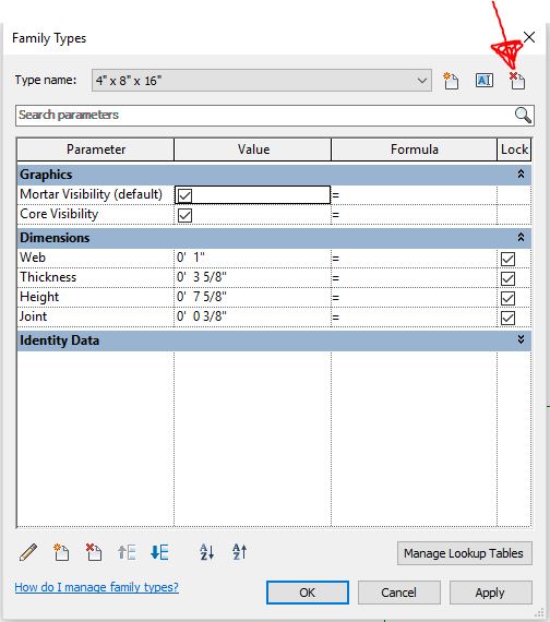

Some famlies have alternate options, like CMU blocks, 8x8, 8x16 etc. How do you delete those options from the family?

Open the family and under the Family Types there is a delete family type button.
