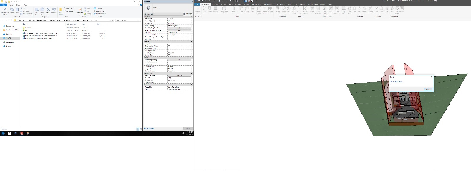

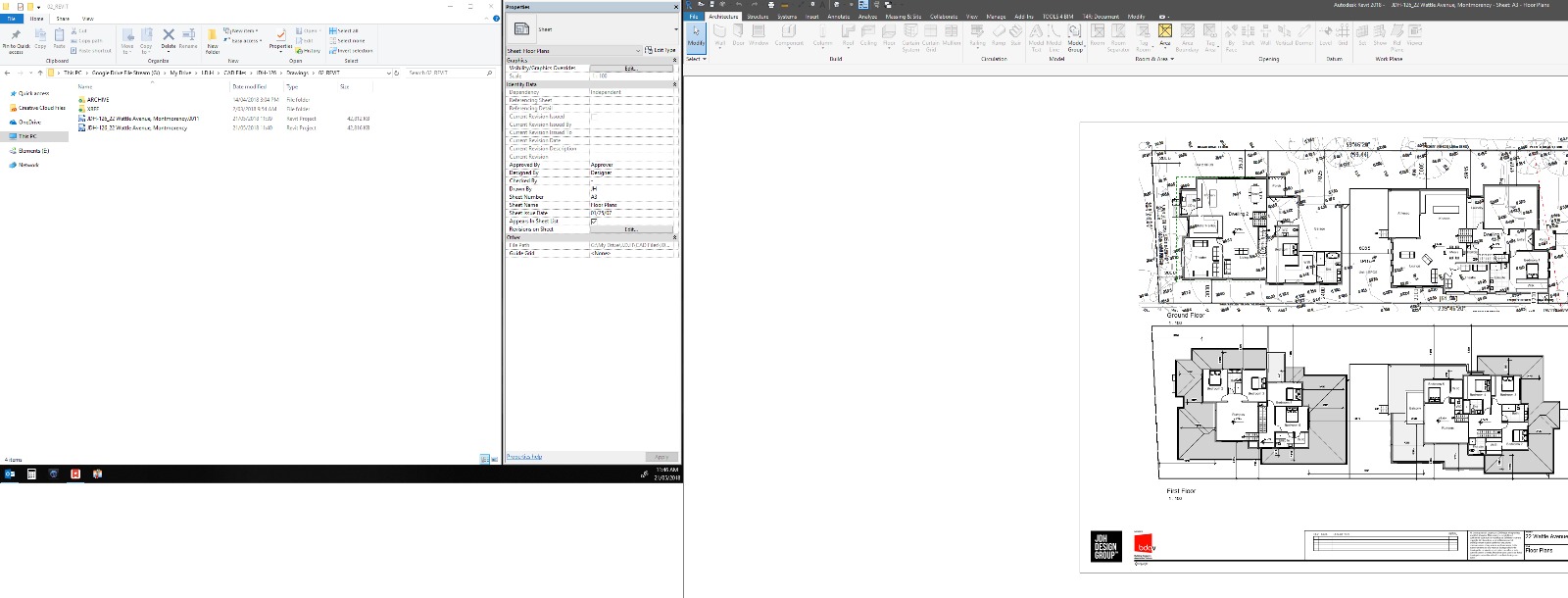

Hey guys I have been having this issue on a couple of jobs now.
I will be working on a file and clicking save and all good... then all of a sudden I will click save and it will say FILE NOT SAVED and I check my drive and it is now down from 80mg to 0kb...
I then have to save to desktop and replace the existing file on my drive.
I am running off google drive but have them available for offline use meaning they are on my pc. Been running this for a while now with no issues just all of a sudden. Any ideas? Cheers.

I think if I click save while the drive is syncing then will cause the issue. If I wait and resave to google drive then works again...
Definatly a google drive problem!
