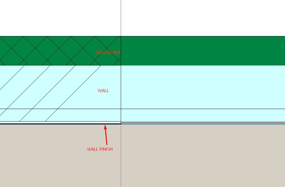

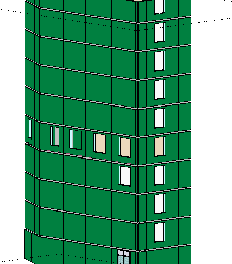

Good day! I grouped all elements (walls, floors, insulation, fixtures etc) in order to use this group on typical levels of my project. All changes in the group are reflected on all levels. However, I added window openings on my walls and joined the walls with outer insulation which is also in walls family. So openings were properly cut but this change only occured on the level I was working in as shown in the snapshot. I wonder why isn't this reflected on other levels?

Yes, all elements including walls are in one group because I have typical levels. Why is not that good idea? In the attached screenshot I showed the plan view taken at the window. My wall details are as follows:
1) Outer layer - facade tiles (not shown)
2) Insulation 130mm
3) 250mm blockwork
4) Inner layer - 20mm plaster
Insulation, blockwork and plaster each is drawn as a wall family. I introduced windows and joined elements but this change isn't reflected on other levels.

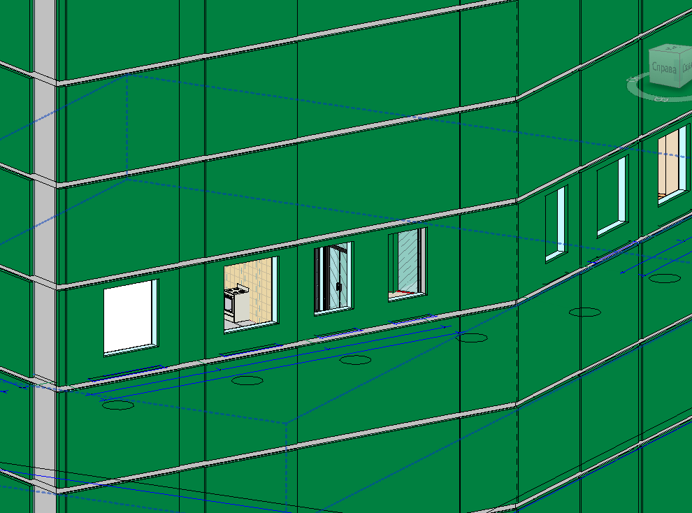

Yes, windows are also in the group. Actually those are wall openings. Now I am planning to select the walls on all levels and join the walls manually again. The weird thing is that the windows on the side of the building worked out well and appeared on all levels when I placed them on one level.
