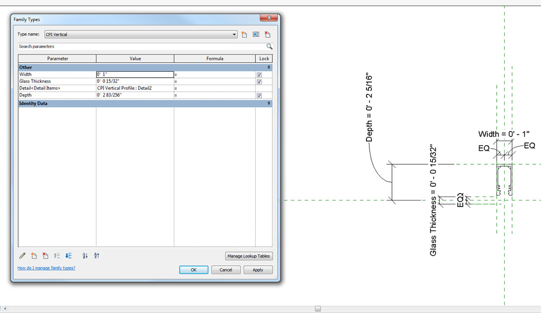

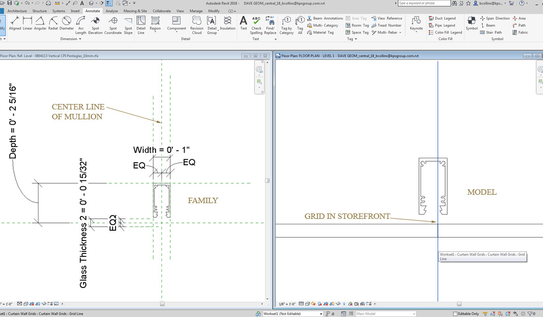

There has to be something simple that I'm missing.  See the attached image.  I have a vertical mullion built as clearly and simply as I can.  There are a few parameters I will probably never need, but they're not in the direction of the problem. The mullion is centered and EQed in the family.  When I place it in the model, it goes off center by 11/32".  If I remove the EQ and off center the mullion in the family 11/32" it aligns with the curtain grid in the family.
I can use the work around, but would feel better if I knew the problem.  Thoughts?
Thanks.
.blc
EDIT: I've added a screen shot of the type properties.

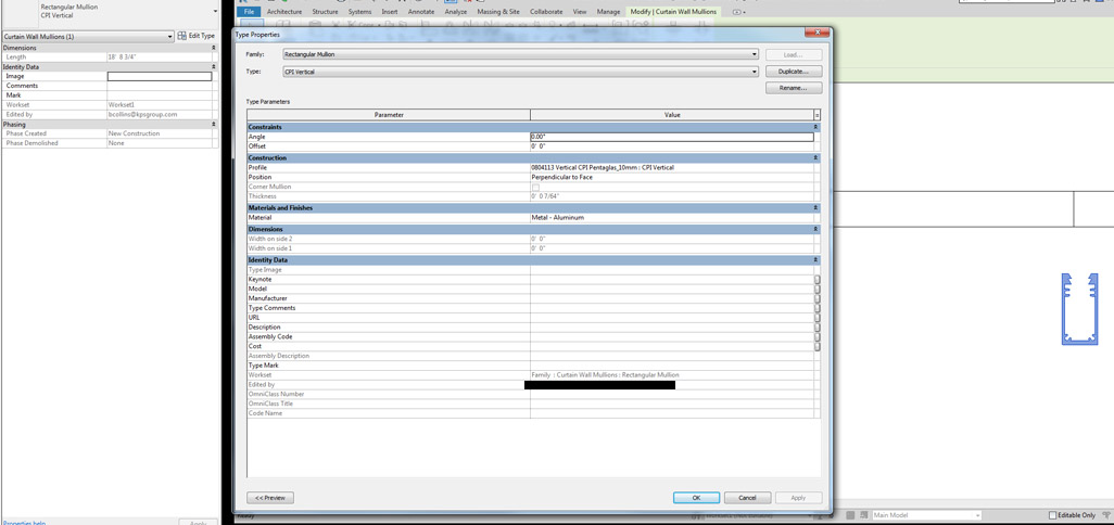

Look at your mullion type properties - width on each side.
Fri, Apr 27, 2018 at 8:51:19 AM | Vertical Mullion not centered in model but centered in family
benlink
Joined: Fri, Jun 6, 2008
42 Posts
5 Stars: 1 Votes
Thanks for the follow up.  I tried to upload an image of the properties, but it kept deleting the image of the mullion.  See attached.
Maybe I need to add an offset to control it, but I would think that as it's set up, it would center automatically.

And, see attached for the properties in the model.
