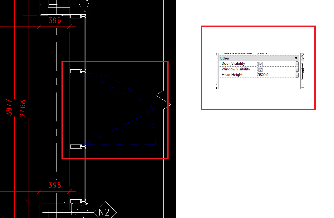

Hi,
I have a 5.8m height of curtain wall.
At the bottom level we have a door and at the top of the curtain wall we have a openable swing panel.
I assigned visibility parameters for both the door and swing panel opening projections on the plan.
But the problem is when I load the family into my project, I could not have separate controls for the door and swing panel in different levels as I expected.
All I need is want to have separate visibility controls so that I can turn off the door in level 1 and turn off the swing panel at level 0. At the moment both the projections are visible in all two levels.
Please suggest me what to do in this case.
Thanks.
Mon, Apr 16, 2018 at 12:56:54 PM | Visibility controls
Dheena14asian
Joined: Sat, Oct 8, 2016
0 Posts
Solved it myself !!!
Created different object style for door opening and swing panel in the family.
Then after i load the family into project i created two different view templates.
Applied those view templates to different views.
Then I simply turned off the object style in visibility settings.
By this way other view is not affected.
