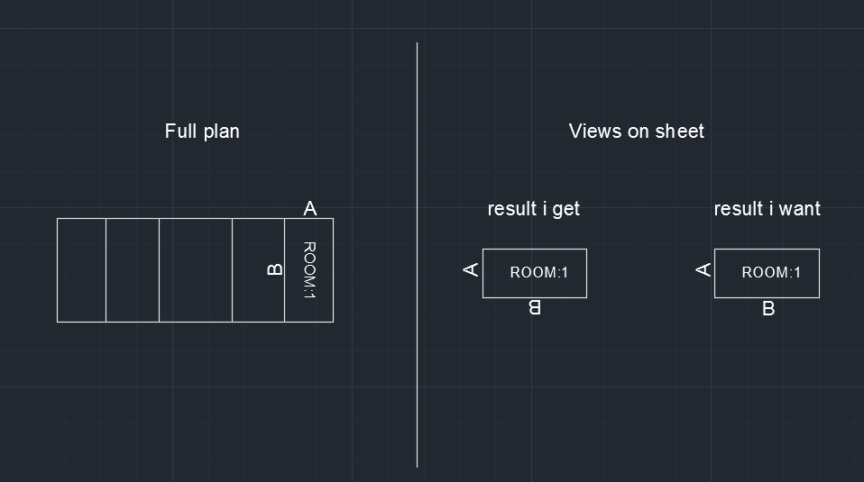

Hi,
I work in a project,
The orientation of the building is as shown in the left side of the attachment.
But on the sheet I need to put them in different orientation. (as per our office standards)
I make dependent views for all rooms and put them on sheet. After placing the views on sheet I rotate them using 90 degree rotation option.
The problem is All my tags are not in readable direction on the sheet.
I tried all way but nothing works.
Changing true north I can change the building orientation from horizontal to vertical and all the tags are in correct direction as want.
But I don’t want to mess with this since I have real true north value to be applied later to the building.
Pls suggest me any good way to fix this.
Thanks

You used rotate view on sheet and that is the wrong process.  That keeps everything the same in relation to how it was created.   Instead, you want to just rotate the plan view.  Read this from your HELP.
Thu, Apr 12, 2018 at 6:27:00 AM | Need to change tag reading direction
Dheena14asian
Joined: Sat, Oct 8, 2016
0 Posts
  Wow that simply solves everything.   thank you very much .WWHub _/\_
