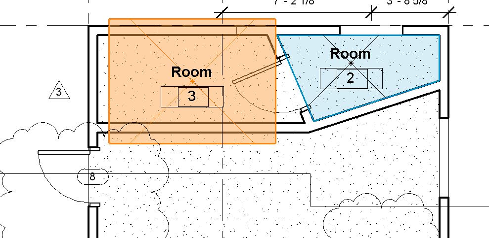

I was making a simple project so I can introduce Revit to others.  I tried tagging a couple of adjacent rooms and one was recognized.  The other said it wasn't enclosed.  What am I overlooking? (Revit 2017)

  1. A wall may not reach the level the room is on.
  2. A wall may not be set to room bounding

I selected a wall and right clicked select all instances... all are from 1st floor to top plate and are room bounding.  Attaching to the roof shouldn't make a difference, should it?  I drew 4 new walls and those are recognized as a room when I tag.  Just can't figure out this situation.

But you didn't say that all of the walls around this room have room bounding turned on.
