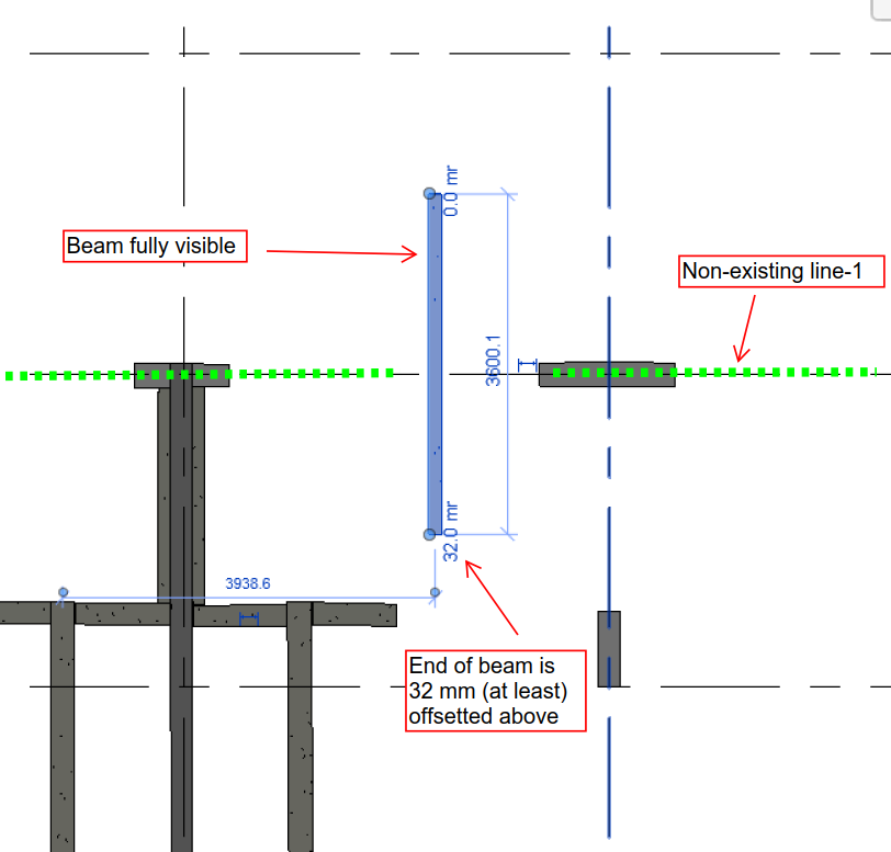

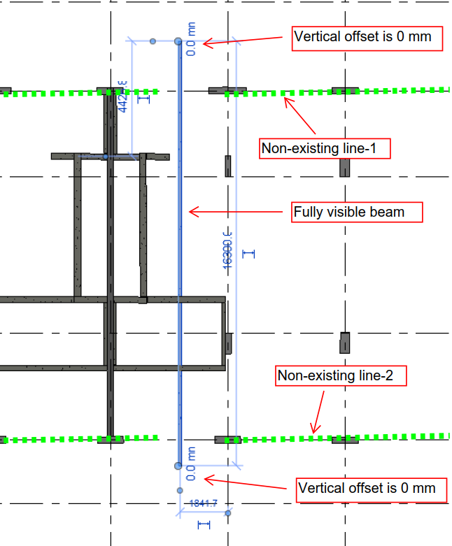

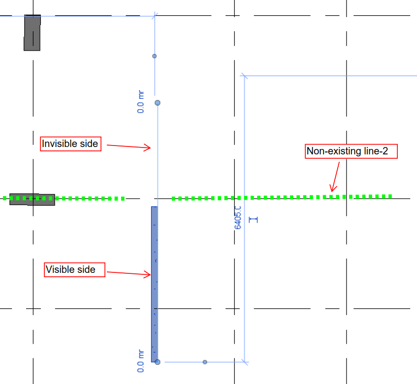

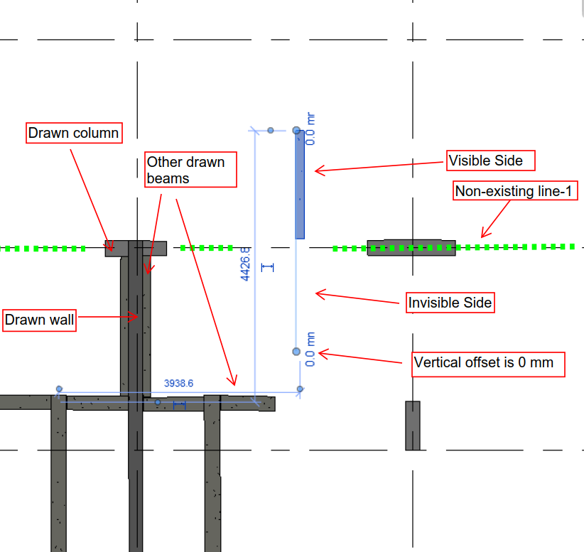

I'm modelling a concrete building with structural columns, beams and walls. Until now, it's been very well but I can't place any beam that crosses that particular non-existing line. In fact, two lines. Whatever I try to do, I can't make fully visible beam. Although the beam appears partially, I can select it. When I get cursor on the beam, it detects beam and when I select it, blue line of the beam is appearing. But in any view, I can't make it fully visible. Allways partially visible (which is on one side of the line).
And the interesting thing is, when I offset one end of the beam at least 32 mm above, it's fully visible. But it's not the level I need.
Other interesting thing is, when I make the beam cross both those non-existing lines, again fully visible. But it's also not the thing I need.
I mean either my beam will intersect with both non-existing lines or non of them.
What's the reason/source of this problem? And how can I solve this?
P.S: I tried visibility options, view range, detail levels, visual styles, different beam families and beam types. There's not any void extrude or blocking object.
Please take a look attached screenshots for understrand the problem exactly.
157055_Screenshot1.png157055_Screenshot2.png157055_Screenshot3.png157055_Screenshot4.png

The issue is solved. I don't know how but  since I restarted computer, beams look perfect. I think it was software glitch or something.
