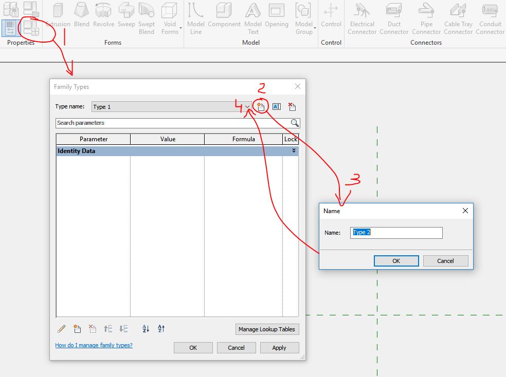

Are you talking about the Family Types? In your family, open the Family Types window. Create as many types as you wish and adjust the parameters for each type. Also, see the Help Menu.

I think you are thinking of an on screen database type solution - i have never seen such available within Revit (yet)
I agree with pijpiwo - create different family "types" with the data and dimensions set correctly for each type. Once you have placed an instance of the family in your project, change the 'type' to be the one you require for that location.
