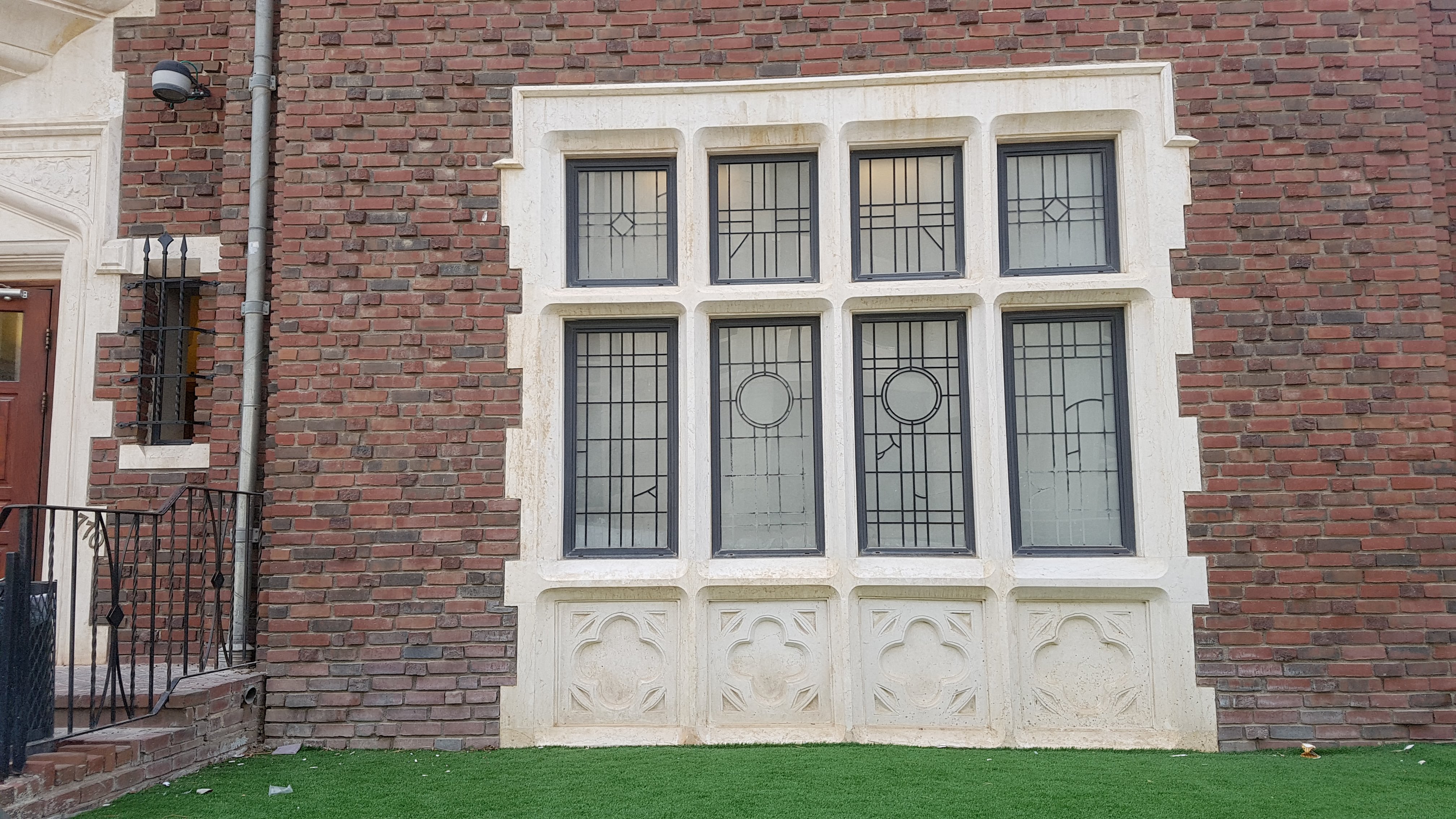

I need to create a window with many divisions.
I have a bunch of these windows and there are a bunch of different sizes.
see attached picture, I need to create those windows.
What is the best way to do this?

Each one of these is so unique that I don't think a family will work well.  I would do a window that is just fame and glass... a normal window, and use that for all of these.   Then from an elevated view, I would do in-place familes for each window, hosted by the glass, that would define all of these muttions.
