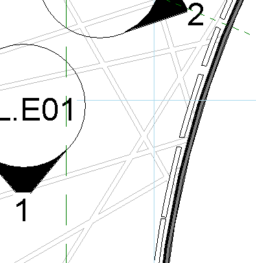

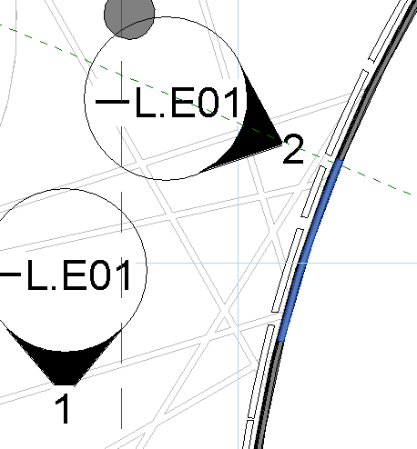

Hi!
I'm having issues with a linked model - the wall openings are not showing up in the plan! I've checked the view range and it's correct, I tried changing the visibility graphics of the walls and that did nothing. The weird thing is that I can select the wall openings by tabbing to them when my mouse is over the linked model in the host model (see the attached image), but they aren't showing up!
Any suggestions?
Thanks!
Thu, Mar 15, 2018 at 7:43:24 AM | Wall openings not showing in linked model
Your images mean very little to us.
Show us a 3D view....even better, show us a section through the window.

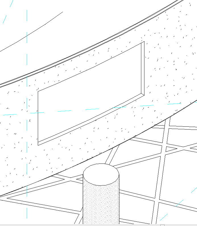

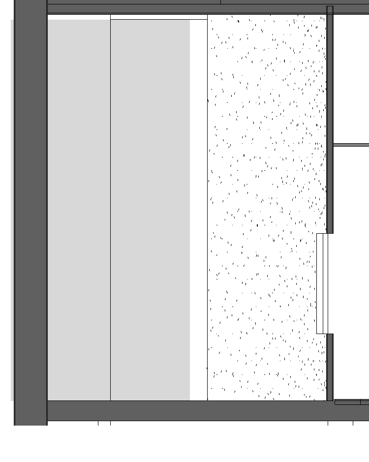

Thu, Mar 15, 2018 at 11:53:22 AM | Wall openings not showing in linked model
kjrhg
Joined: Fri, Jan 19, 2018
0 Posts
Thanks for your response - and apologies if it isn't clear what's going on. The wall openings are showing up fine in section and in 3d (see attached images of the same curved wall shown in the previous images of the plan). The issue is that it's not showing up in plan. The cut plane of the plan is correct and it should be showing up.
Any idea why this might be happening?
Thu, Mar 15, 2018 at 2:07:06 PM | Wall openings not showing in linked model
Did you make the window family?   If so, did you change the elevation of the window plan view?  It needs to cut the window in the family.
You are not using a linked view, correct?
Are you using phases?
Many other possibilities.   What is linked and what is in your model?
