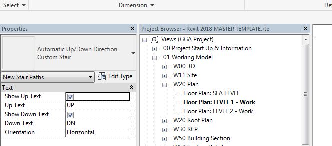

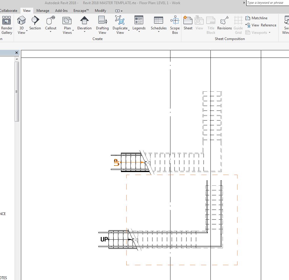

I have searched and tried methods posted to get my arrow to show the full length of my stairs and still nothing. I have attached a view detailing. How can I get the stair path to show full length.
I have added a plan region. Selected Automatic Up/Down and still no full length arrow. Any help would be appreciated.

Never mind I am an idiot. I totally missed the VG_annotation. I only looked under Model Category. We all have our moments.
