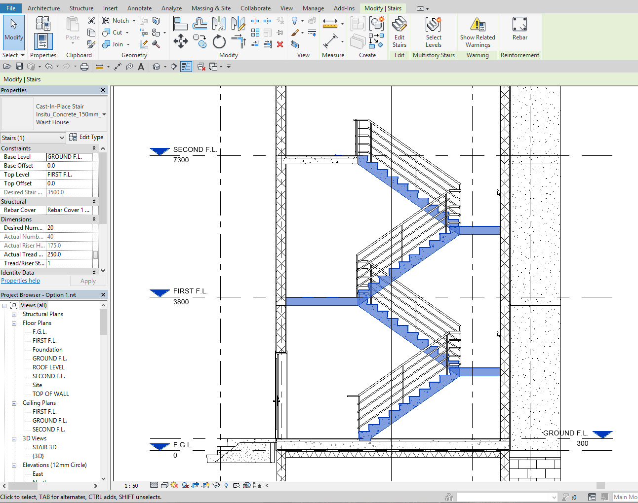

Hi,I've been working on a multi-story stair case and I had to delete the stairs and start over. When I tag the stairs with the tread number tag, it carries on the numbering from the previous numbering. So in my case the number begins at 21, rather than 1. Is there any way to reset the numbering? I am using Revit 2018.Thanks

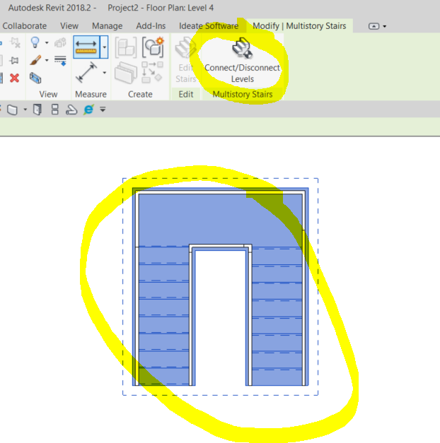

What Tag Family are you using ?
It sounds like you still have 'Connected Levels' from the previous stair ?

See image . . . .

Yeah I did have a connected stair from a previous one but I had to delete it as I couldn't get the railings on the landings at the floor level to connect. I've attached an image of the section of the staircase higlighting it and the ground floor plan indicating the tread numbers.
