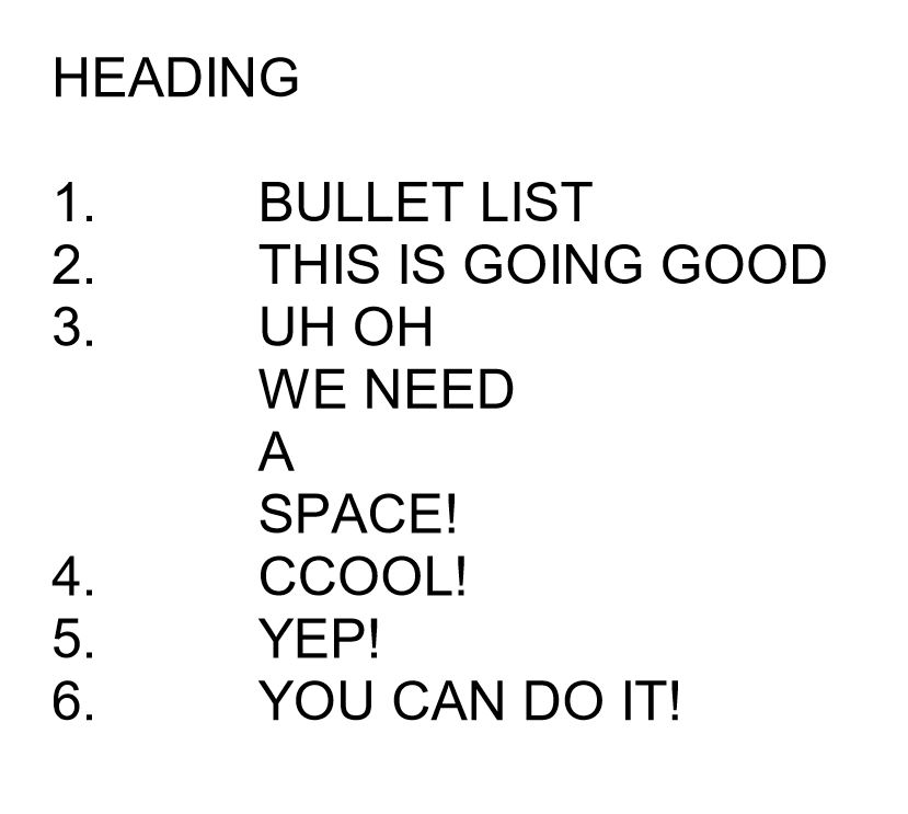

Shift-Enter is your friend.
See attached image for example
**To add, instead of typing a word, hit the space bar for your space....  But I'm sure you could have figured that out.
