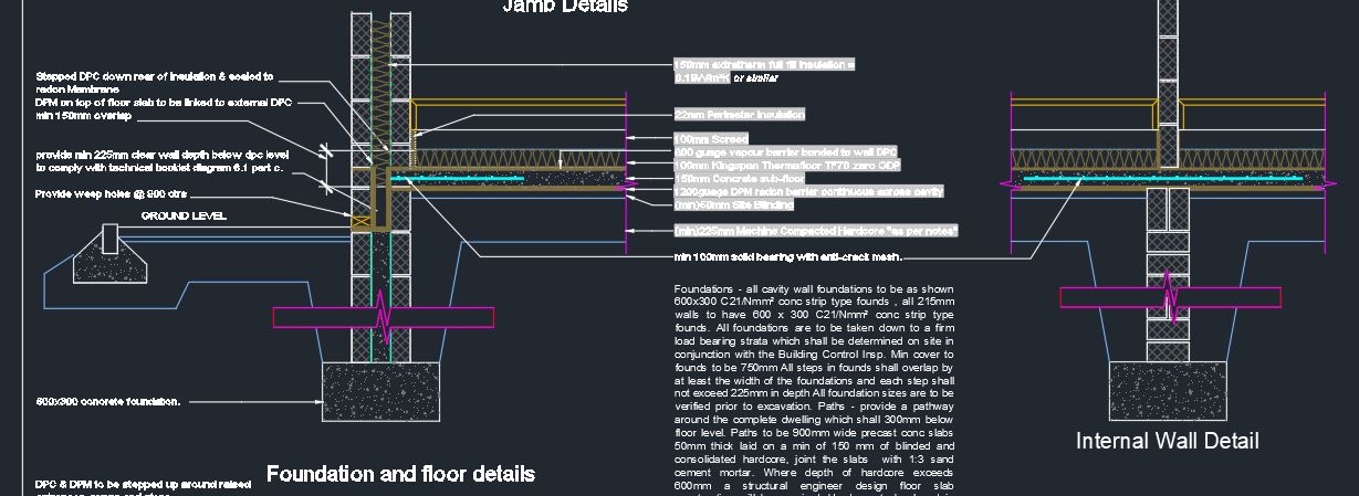

How would I create these walls, would I need to set levels at top and bottom of concrete slab, I am currently learning how to use revit.
I am using Revit 2018
Tue, Feb 20, 2018 at 8:37:49 AM | Cavity Wall which includes sub-floor on inner leaf
Walls do not include floors.  Look for some revit youtube tutorials to help you.
