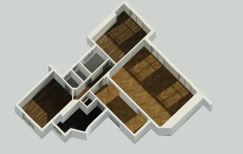

Hello,
I would like to know il someone kwons how to remove shadows in my 3d? (And keep the sun light)
Thank you very much !
Elodie

I already know that.
My proplem is : even if I don't have shadows in my view. When I render it, I have the shadows in my render.
Thank you

Maybe my question wasn't clear enough:
what i look for is how to render without directional source but more with a "global illumination setting" with no shadow cast but with the quality of a rendered image, all this without leaving the Revit interface (i could easily do it in an other software but I try to keep the workflow as Revit Native as possible).
As you're asking a project is not only about depth, sometimes shadows can blurry the message your image is supposed to send in space planning or organization purposes (precisely the case here).
I honestly Thank you for the time you're taking for my topic although I have to admit the judging is a little disapointing.
Tue, Jan 30, 2018 at 12:03:23 PM | How to remove shadows?
No judging, just responding to your questions as asked.  If you had already used the processes outlined in your Help, that would have been good to help explain your issues.  Now when you mention space planning, it sounds like you may be rendering a plan?  Again, a better question can result in a better answer.
