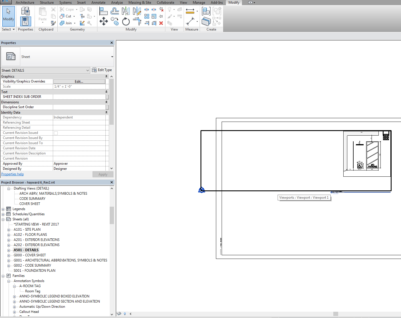

I have created a site plan callout (HC parking Stall) and have placed it on a detail sheet but the crop region includes the project base point making the viewport huge. how do I exclude the project basepoint/survey point (if this is the issue) to capture just the callout area? thanks.
Wed, Jan 17, 2018 at 4:13:42 PM | Revit 2017 - Crop view extends to include project Base/Survey point
Turn the PBP off in the view.

Yep, Thanks!
