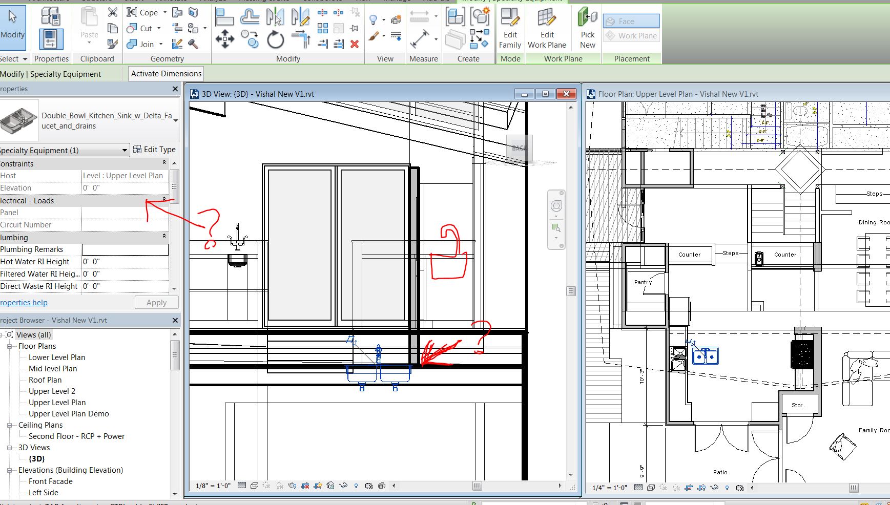

Ive placed a model of a sink. I need it of course 3' up off the floor plane, but the option is greyed out. Ive used this model a bunch of times and this is the first time I cant change that. so the sink model sits into the floor plate instead of at counter top height. any suggestions?
Thanks in advance. See pic

You may try "Pick New" on the "Work Plane".

You may try "Pick New" on "Work Plane" then selet the counter top.
