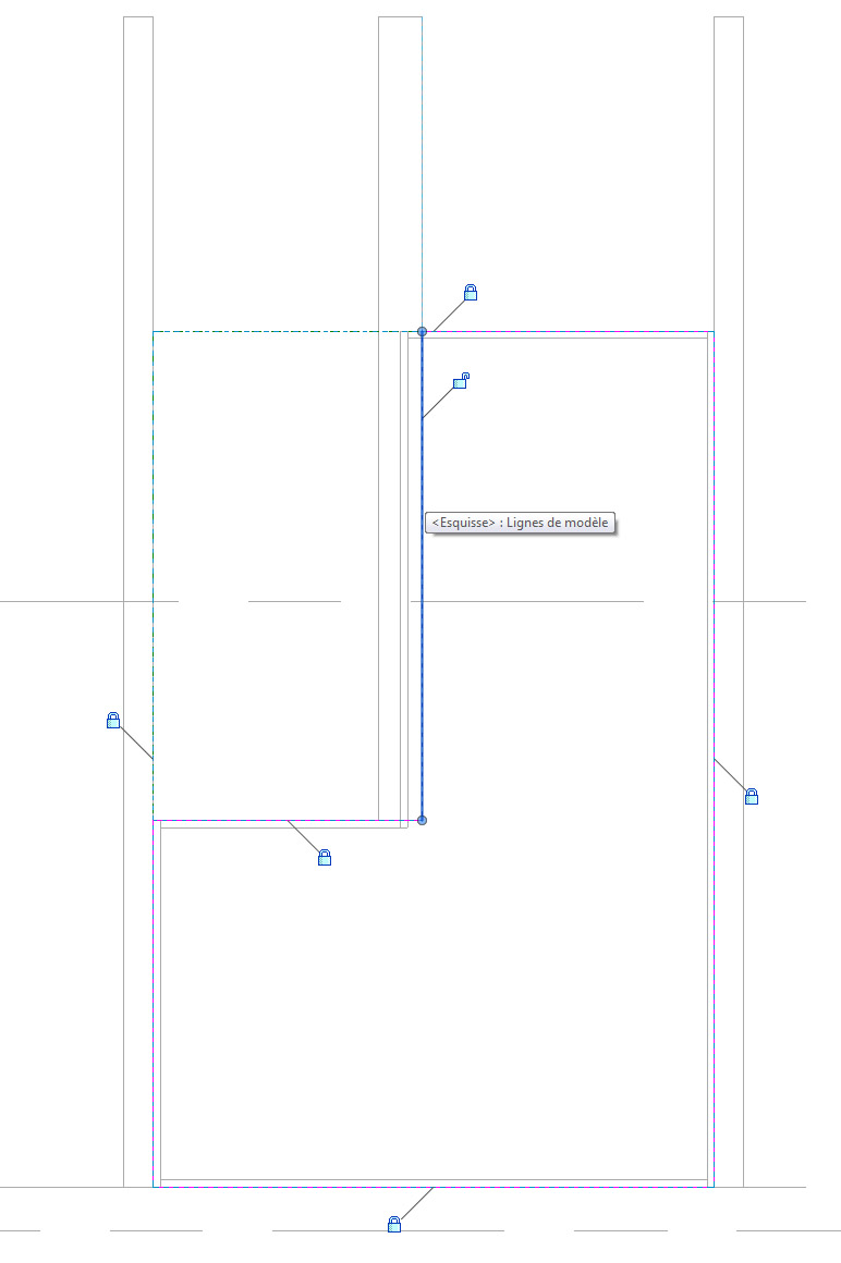

H there,
I want to modify a curtain wall to have it's own form, modify profil,
but the middle ligne keep constraint with the middle of perpendiculaire wall,
I try constaint lock edit joint,dissalow joint   nothing work
how can have the limite then the mullion align with the right exterieur of the wall,
thx you a lot,

And then you realize the entire world as the same problem since 2008. http://forums.augi.com/showthread.ph...3-Wall-Joining
https://forums.autodesk.com/t5/revit...n/td-p/6728135
https://www.revitcity.com/forums.php...hread_id=25477
https://www.revitcity.com/forums.php...hread_id=17408
and was never solve by autodesk ok I found a work around , create your wall as "in situ" family, if anyone find a better solution thx

Ok great I achieve to add a parameter spacing to the profil mullion, also a Length & wide parameter, so you can edit the mullions profil , as is become a families and no more a system mullion, then You can edit the profil of the glass panel, so problem fix except in the case where you panel is not a "system panel" like glass or solid , in my case multi-layers wall with isolation , in this case you can't edit the profil, but it work fine for system panel edit_profil.jpgprofil.jpg thx a lot any thought about the system panel ? I can make in-situ panel just for this panel,
