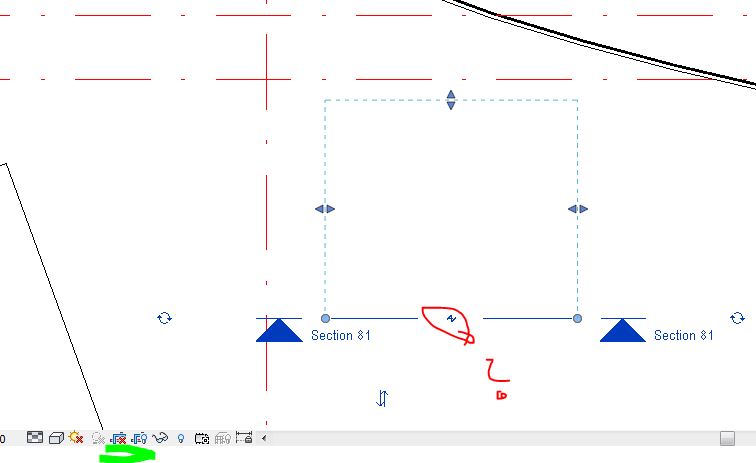

Hello,
I needed to advise about the section line in revit. The section line does not divide. When I click on a break symbol, it changes colour of line to divide, but I do not see the handle blue dots. Do you have some expirience?
thank you

You must configure it: in Type prop. of the "building section" open "section tag" field and in "broken section display" set "gapped" instead of "continuous"

Ou, thank you so much. It works great.
