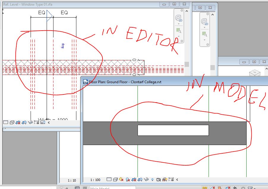

Hi ,
I need help on this one if anyone could assist me.
I tried to create the window. But it seem the wall is just run through it and it does not cut the wall  in plan view of family editor.
It look ok in either section, elevation and 3D view in the window family editor.
When i tried to load and put it in the project. it show white (for window area) and dark colour as if the wall it build in fron and back of the window.
COuld someone help me with this please.
THanks.
GOdlief

You say you created this window.  Did you start by using the door template?  How did you define your opening?

In the family, lower the window (or raise the cut plane) so the view range cut plane actually cuts the window. Right now, you have the sill at 1290 and the cut plane at 1000.
