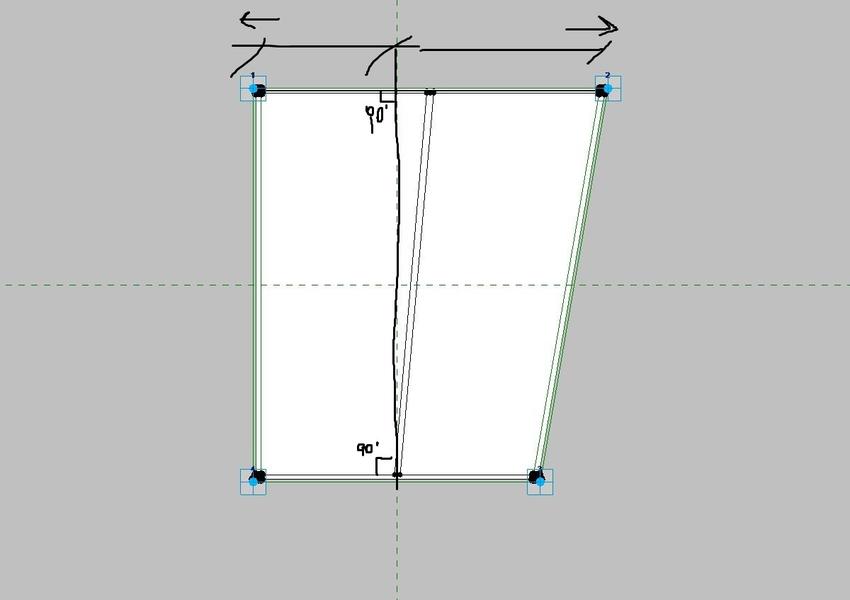

Good evening at all,I wanted to ask if you could help me finish a parametric family. in practice I created a new family with 4 adaptive points, then implanted the model with various reference points that served as the basis for the adaptive profiles of the uprights. The problem is that the central pillar is always in the middle, I wish it always had a 90 degree angle, would you suggest some solution? I attach to the pictures, thank you

Use a reference plane at the align both the center adaptive points and then use an equality dimension at the bottom
