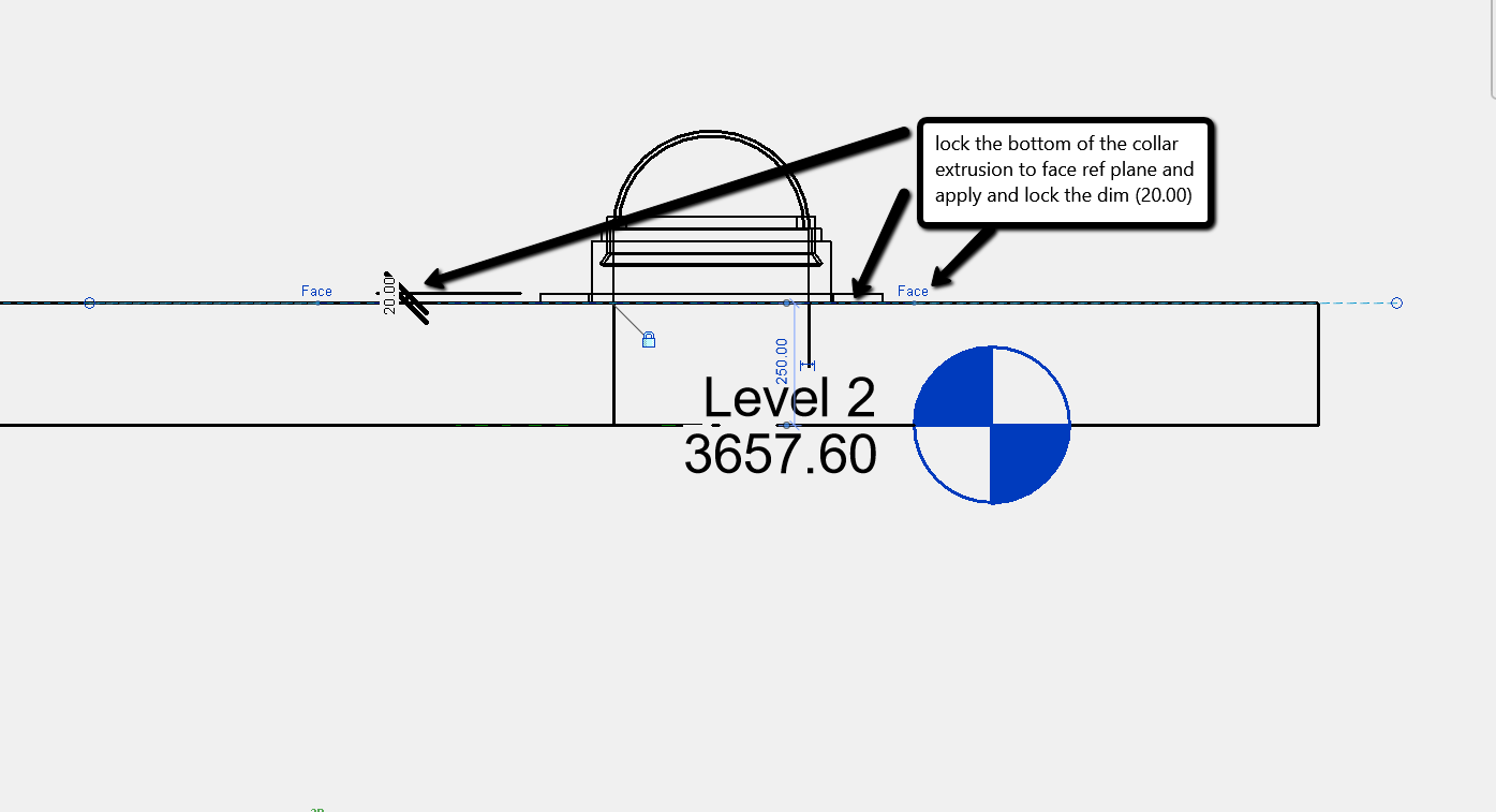

So both the skylight and dome tube skylight I have (I think Ive gotten from here) look good in the family editor, but when you use them, they seem to "stand off" the roof place they should be hosted to. does anyone know how to clean this up or fix it?
picture and the two models included.
THanks in advance!

With the dome, see picture.
The skylight, I think, works as intended. The flashing should be elevated. If you don’t like it, what do you want to change? Lower the entire skylight or lower the flashing only keeping the skylight height as is?
