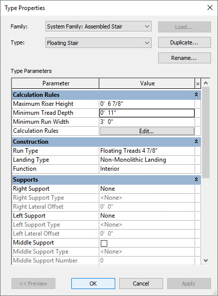

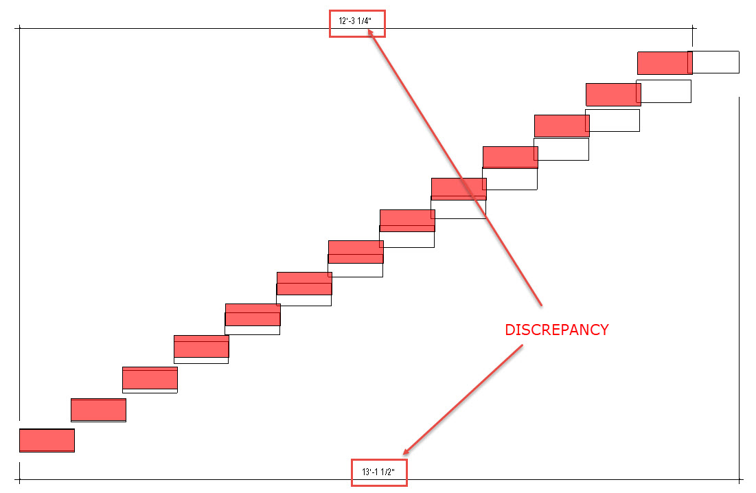

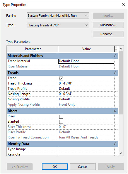

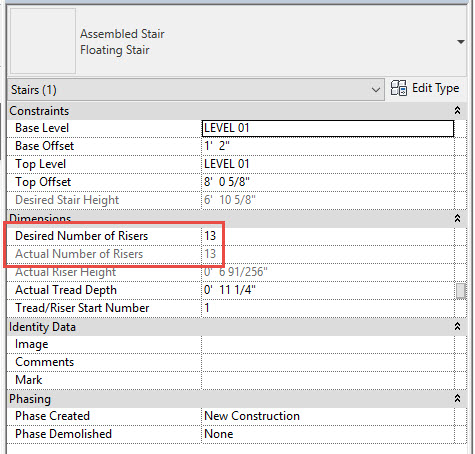

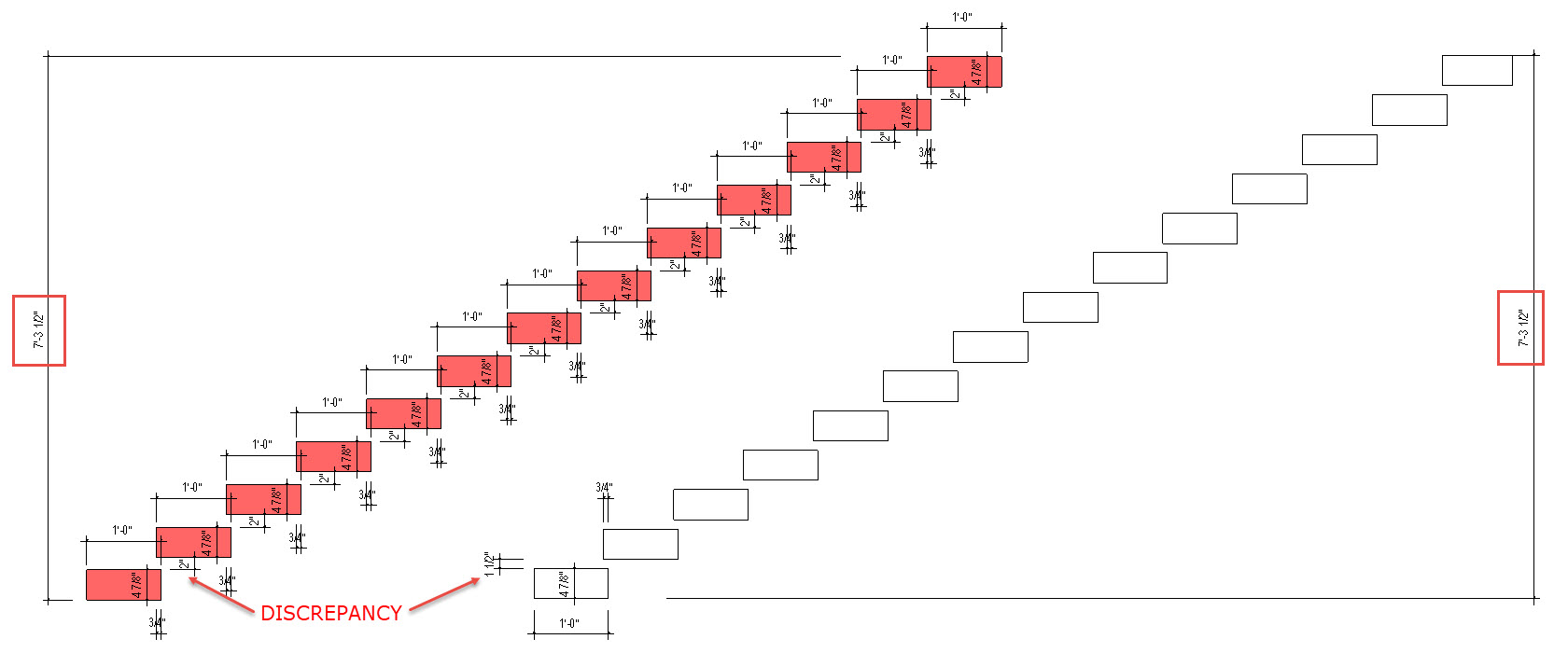

I inherited a project with a modeled in place stair. When I looked at the stair I thought why would they model that in-place its so simple....or maybe not?
The stair in the attached images highlighted in Red is the existing model in place stair. I am pretty sure i have set up all the properties correct to mimic the stair which is basically a 12" stair depth with 3/4" overlap thus leaving 11 1/4" nosing to nosing depth.
Why dont my stairs align? what am I doing wrong??
There seems to be some difference in the way Revit is creating offsets of the treads that I am not catching, notice the Model in Place stair is 2" between treads and Revit Stair is 1 1/2"
156037_Stair_Separate.jpg156037_Stair_Overlap.jpg156037_Stair_Type_Properites.jpg156037_Type_Tread_Properties.jpg156037_Instance_Properties.jpg
Mon, Nov 6, 2017 at 5:08:29 PM | Floating Tread Stair
bruff730
Joined: Sun, Jun 22, 2008
6 Posts
Wow if that isnt user error if iver seen it....the Revit stair has 14 Treads.....Admin can remove this post
