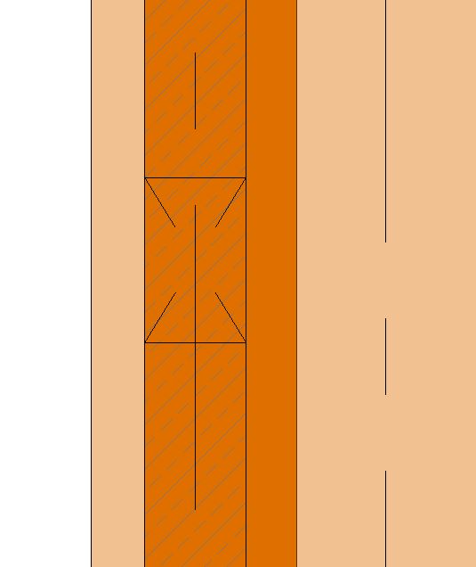

Hi, we created an empty window family for wall reservations. i want to see my reservation's lines even the plan plan cut from below it. I locked model lines to reference plane but it appears in family's default referance plane and moves with the family in the project, does not stay in actual reference plane (floor levels) in project. Any idea how to do it?

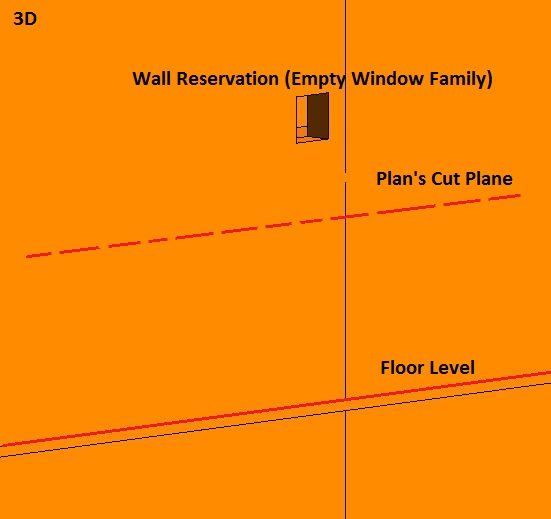

Hi WWHub, thanks for the reply. Basically i want to show wall reservations for MEPs on the plan. But since view range's cut place is set below reservations on the plan view, model lines does not show up in the plan. Window with no opening cut is not an option because we check clashes between MEP models and structure with Autodesk Naviswork's clash test with max 1cm tolerance. So opening cut is a must.
In fact, i don't know if it makes any difference with or without opening cuts but i already tried your solution. Problem is, model lines stay in the family's default reference plane when i load the family to my project. For example, family's default sill height is 50cm, but my wall reservation is 250 cm in my project. When i load the family with model lines to my project, model lines still appears in 50cm below the family. Since there are lots of wall reservations, changing the default sill height is not an option.
