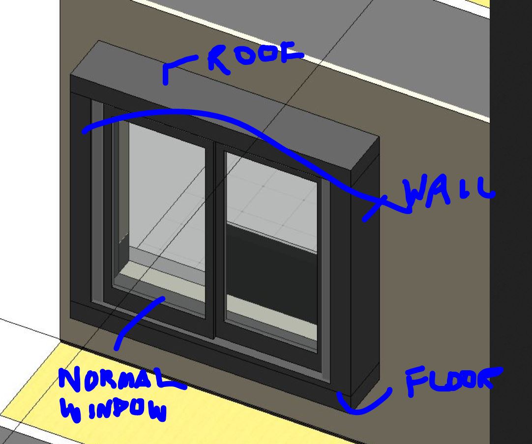

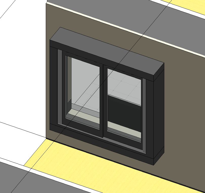

HeyDoes anyone knows if theres any window family like the attached photo? i'm tired of building it with floors and walls everytime :-)Thank you.

I have created a window like that recently. You need to start by placing external walls, floors and a roof that create the box that is attached to the outside face of the main building wall. You will also need to cut a hole in the main building wall to ensure clear access between the inside of the building and the space within the box. You then simply place a normal window into the external box wall. See attached markup.
