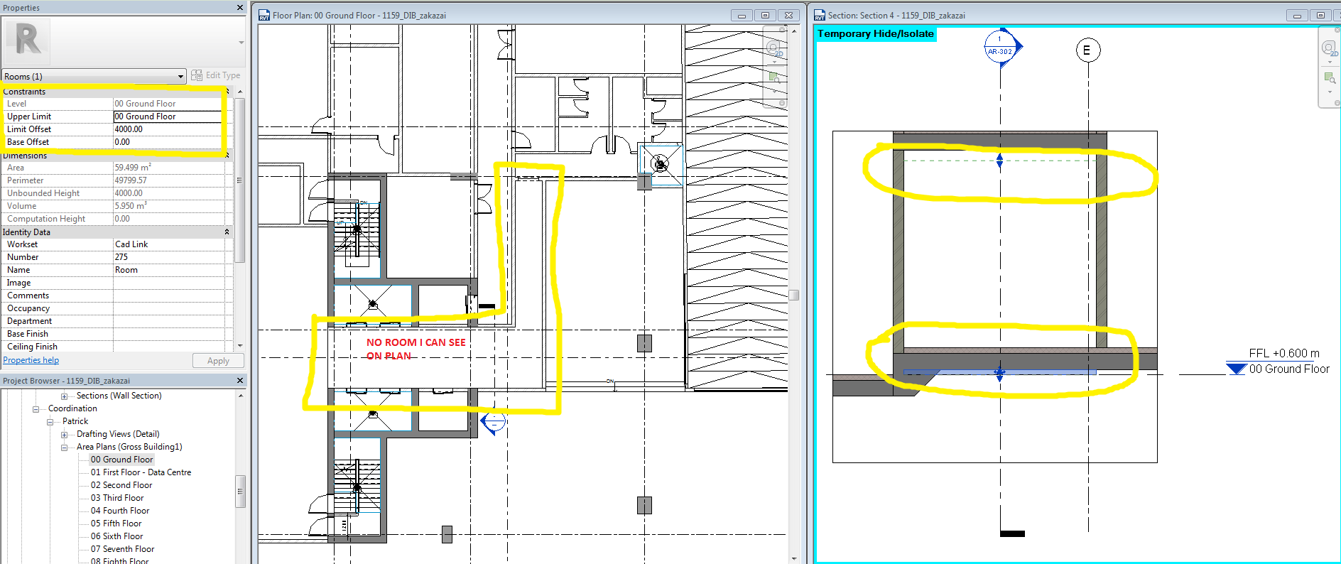

Hi
please find attached Snap.
I cant see my Room or room tag in the plan, where i have raised floor . it is around 500mm above the level line (a lift Lobby)
please advise.
Sun, Oct 1, 2017 at 2:57:39 PM | Room Visibility issue
The floor is room bounding and limits your room as you can see with the blue area.  Redo your room to start at this higher elevation.
