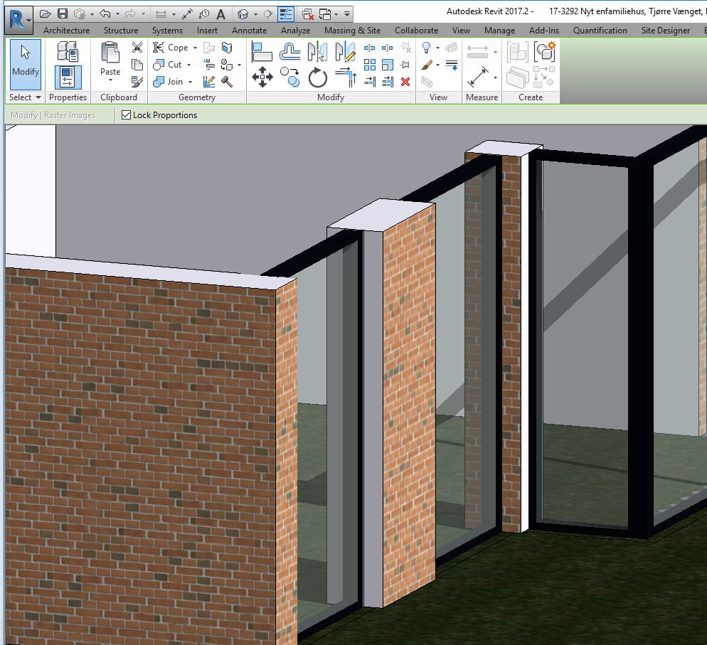

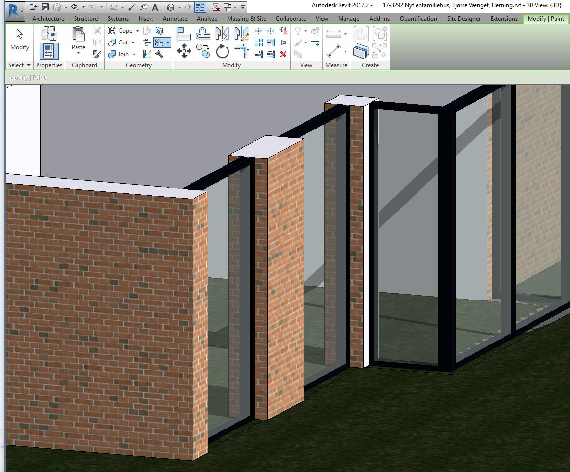

I am almost always using curtain walls instead of windows and doors. they are easy to work with BUT - if i place a curtain wall as a window in my brick wall the brick material will not show in the hole. If i paint brick materiale in the whole it will be on the whole wall face, so i have to split the wall where the coutain wall is placed - any way around this?
I want the wall to have brick on the outside and white indoors - i do not want to split all four faces where the curtain wall embeds the wall.
hope i made myself clear!

i just don't fix my problem with two different materials in the face of the hole. how do i do this without having to split all four wall faces with every window placement?
