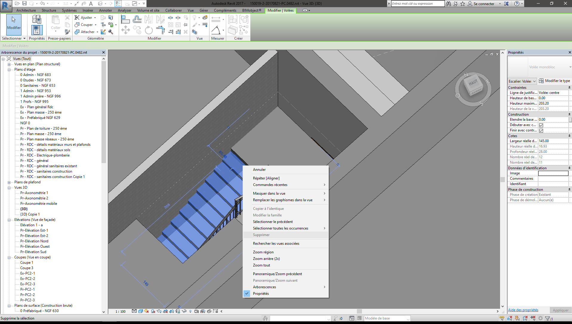

Once created, i tried to manually reduce the width of it, or move it and i couldn't. So i tried to delete it to make a new one but i can't, neither edit it.
Delete line is shaded in contextual menu and the delete button is shaded too.

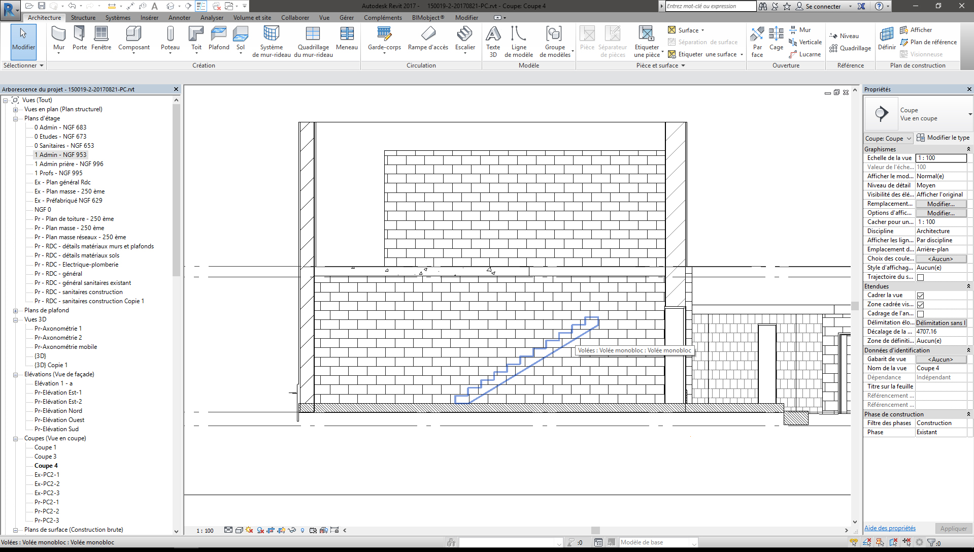

Selecting the whole stair doesn't allow me to delete it. The stair is invisible in plan view, i can only see it when i activate underlays in my plan view.
Weird thing is i can't see it in cut but when my mouse overlap it, it highlights as if it were drawed (see pic linked).
I think it's like the stair is still in "edit mode" but Revit isn't. So i have kind of a ghost stair.

This case we can delete it by using Stair:Run and Stair:Landing schedule.
