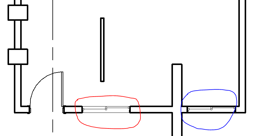

I would like to know the best practice for printing lighter line weight for window sill.
there are work around for it. but is it possible that i can make an option and add to a view template.
please find the attached pic.
i want to get printed like in red mark. i have alot of windows in plan.
so manual work for each window takes alot of time

Something is wrong with the window on the right.  The one on the leftg is typical Revit.   The window on the right does not appear to be cutting the wall at the cut plane of the view.  Maybe the window is too high.

Yeah Done.
Thank u, it was  set projection and cut wall line thickness in same thickness
