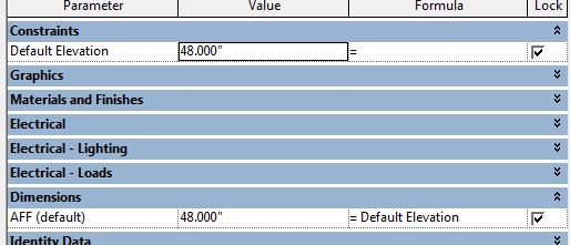

Nice idea W.  I appreciate the suggestion.  I've created a shared parameter called AFF to do this.  However the only parameter I can 'connect' it to is Default Elevation (see image).
Forgive my simplistic questions ...
The family is directly from the Mfgr.  How can I pick up the instance parameter info 'Elevation'.  Must I create an instance parameter in the light family, manage/report the mounting height?  Not sure how, as this is a surface hosted family, not floor or reference plane based.
I've attached the family for your reference.
