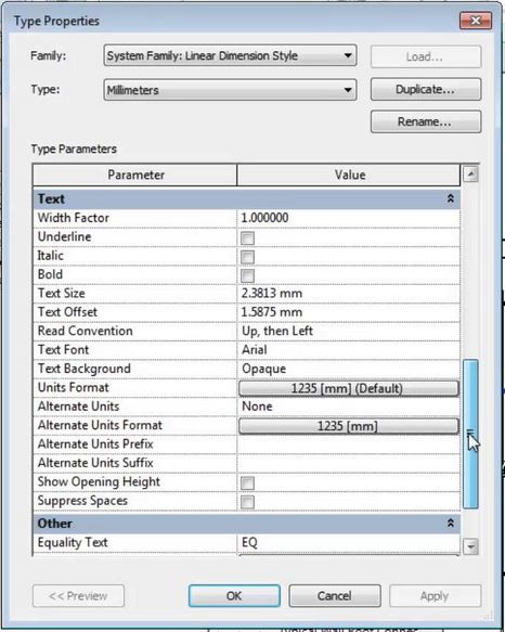

So the screen you are looking at is similar to this?

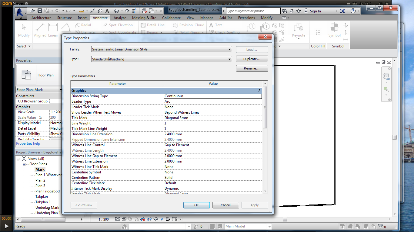

Ok.
I am sorry if I made mistake to explain exactly what happens.

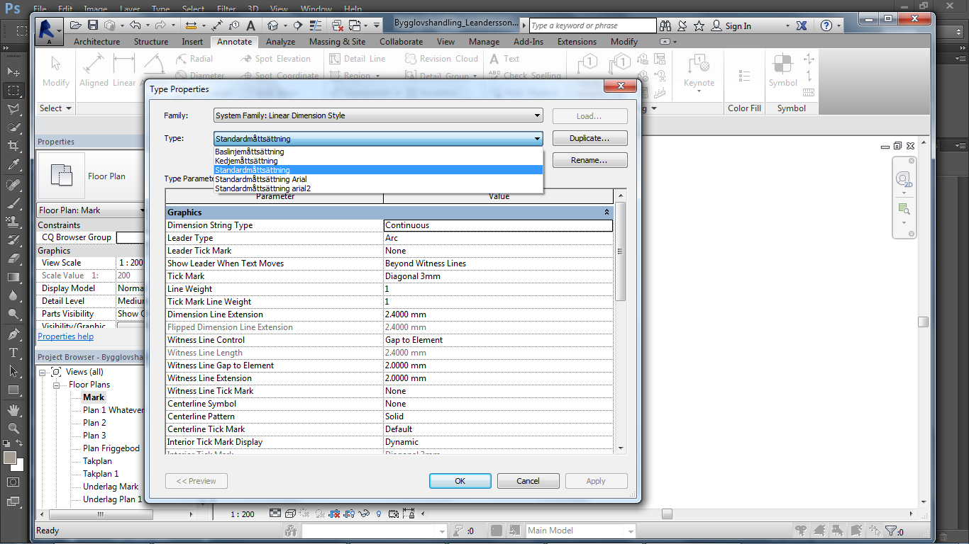

I can edit a new text style, BUT I can't make the new style the used one. Only the ''Standardmåttsättning'' style (see photo 1), is the used one regardless if I change it to any of the other 4. (When I try to change the style to any of the other 4,  the Apply button is allways grey and only the ok button works).
I can change style only if I change the ''Standardmåttsättning'' style directly and not by duplicate it. (is it normal?)
I hope it is more clear now.
Buttom line, is there a way to use the other 4 styles, and what is the method?
Thu, Aug 10, 2017 at 10:21:38 AM | Why I cant change Dimension fonts?
It looks like you already have the dimension styles set although you don't pull down that slider to show what text is assigned to the style.  I assume that Standardxxxxariel one has ariel assigned.
When you dimension, you pick the dimension style from the ones you have available or you place a dimension and change its style after placement.

It seams that I put two times the same reply.
I dont know what happened but now the new style remain.
The only different thing I di was to change dirrectly the ''lets say original style''. Now even if I reopen the file the new style made by me remain.
I don't know exactly what happened.
I will try the same also with the text style, because I had the same proble.
Thank you for helping.
