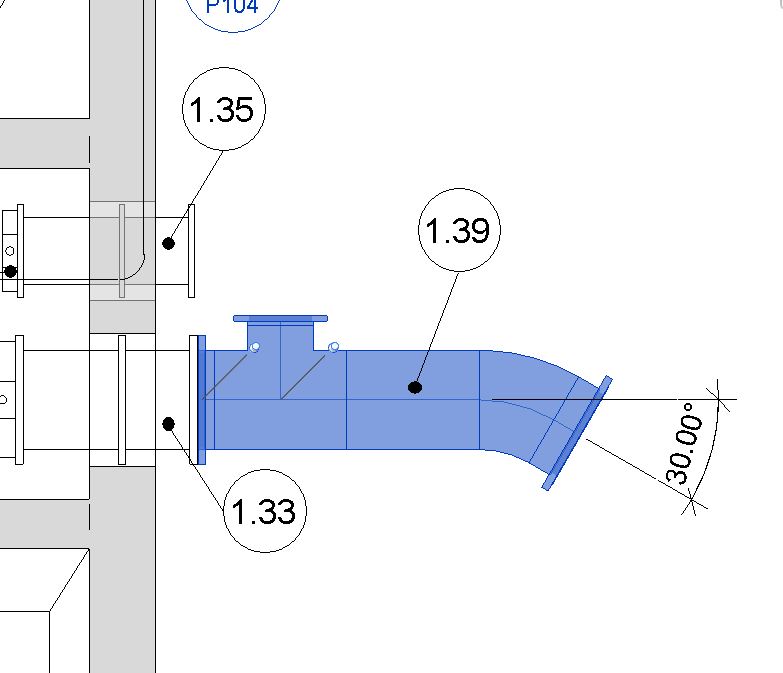

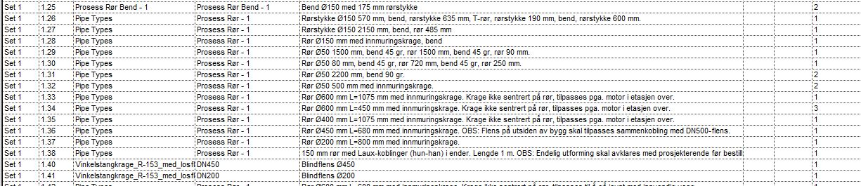

Hi,
I have a pumpingstation where some of the combined pipes will be manufactures as one big piece, and should be tagged as one object in my parts list (schedule). Thus I used "create assembly" from the indiviual pipe elements. Then I added an assembly tag to that big part. So far so good. Now, I wish for this big part to show up in my parts list, with the rest of the single elements (valves, single pipes etc.). But it doesn't. I have used "Mark" to give the elements a number e.g. 1.32. And gave my assembly the number 1.39. Why does it not show? any ideas?
Much apprecated!
