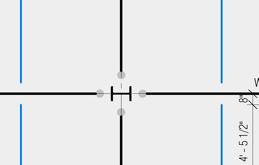

Hello revit users,
I have a problem, my moment frame connection symbol is pale gray. When the drawing is printed it is still grey colored and hard to notice them. I created a family for this simbol and it is presented as a circle made of <invisible lines> that is filled with solid black region. Is there any way to make the symbol true black?
Thank you!
Fri, Jul 28, 2017 at 7:51:13 AM | Moment Frame symbol is grey
Beaucoupnice
Beaucoupnice Avatar
Joined: Mon, Nov 19, 2007
93 Posts
3.5 Stars: 6 Votes
Try going into Manage - Settings - Object Styles - Analytical Model Objects and changing the colour there.
