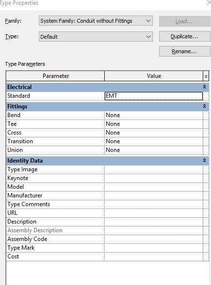

Before working with any system pipe, duct or conduit go to propertie and load the all type of fiitting in the properties panel. attached image shown without fitting loaded

Before working with any system pipe, duct or conduit go to properties and load the all type of fiitting in the properties panel. attached image shown without fitting loaded
