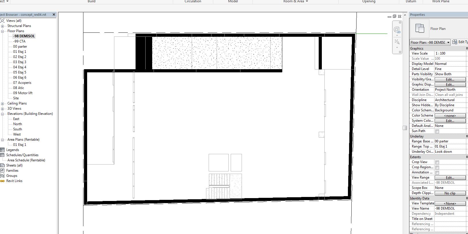

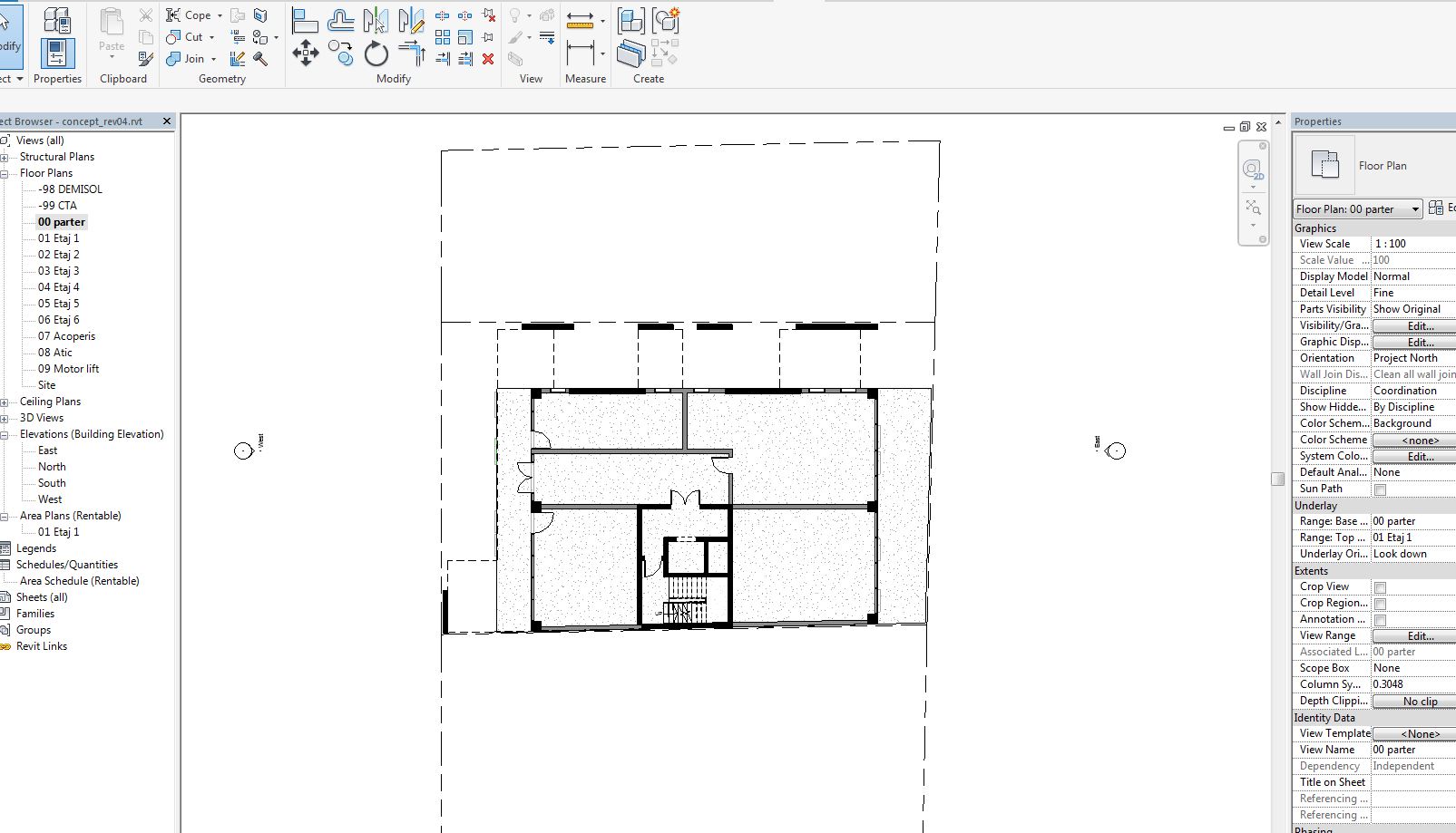

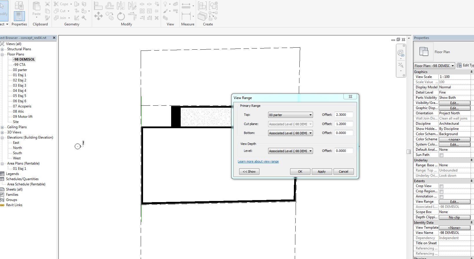

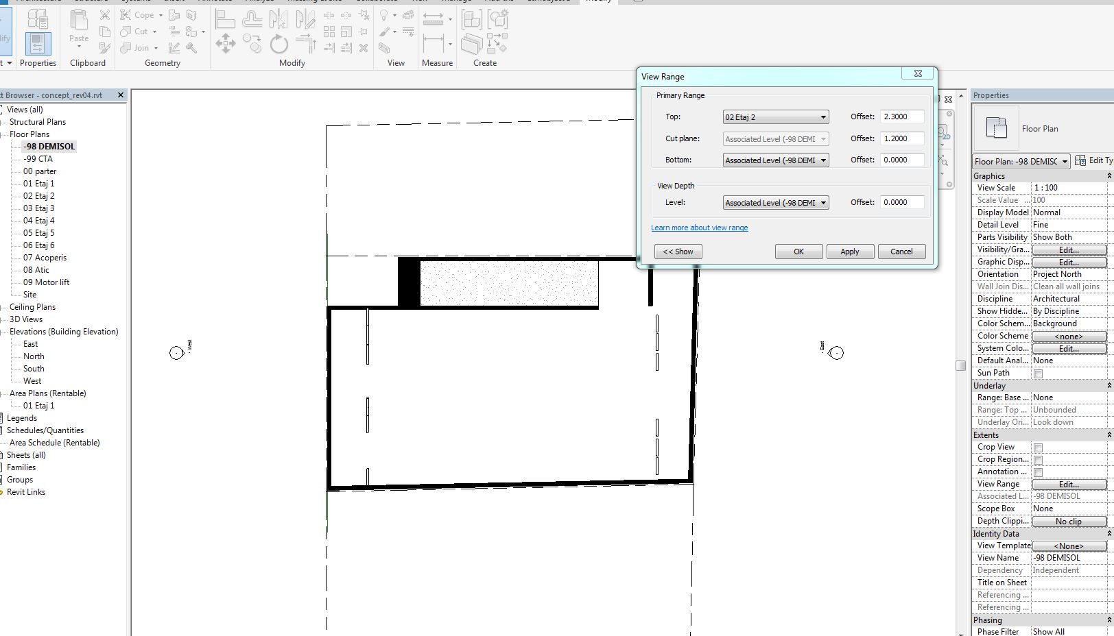

I'm currently switching from AutoCAD to Revit and have an issue: cannot see the walls from an above level, even if my view range is set this way. My view range only shows me cuts through some sunshade components - see attached screenshots. Why is this happening? Why can't I see the walls from above levels.

Do you have a floor?......
Try to learn Revit techniques.  In this case, don't set your view dept any deeper than your level.  Then use the underlay setting to include the floor below.

Of course I have a floor.
Tue, Jul 4, 2017 at 8:39:39 AM | Cannot see walls above current level
Sorry - at first I thought the walls below but I see now you want those above..... Again - use an underlay.

Tried that but again, I can see all elements except the walls. So frustrating.
Tue, Jul 4, 2017 at 9:04:20 AM | Cannot see walls above current level
Read this.
Changing display of walls below current level.
