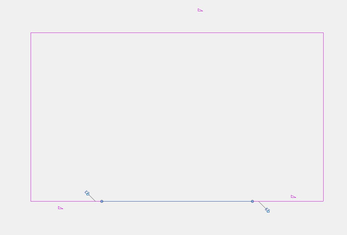

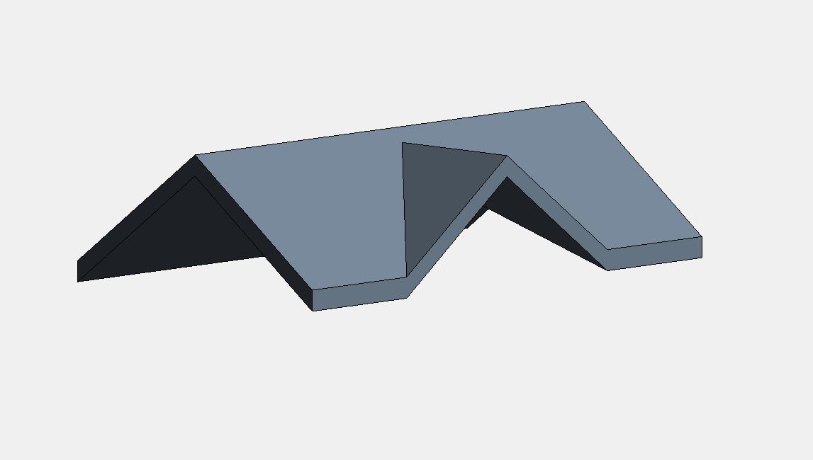

Hello! I am new to Revit. Coming from basic 2D line drawing. I have stumbled my way through quite a bit, but I cannot seem to figure out how to create a false gable. Can some share a best practice for this?

Please provide a sketch/screenshot of what you have in mind. What revit version?

I am using Revit LT 2018. See attachment.

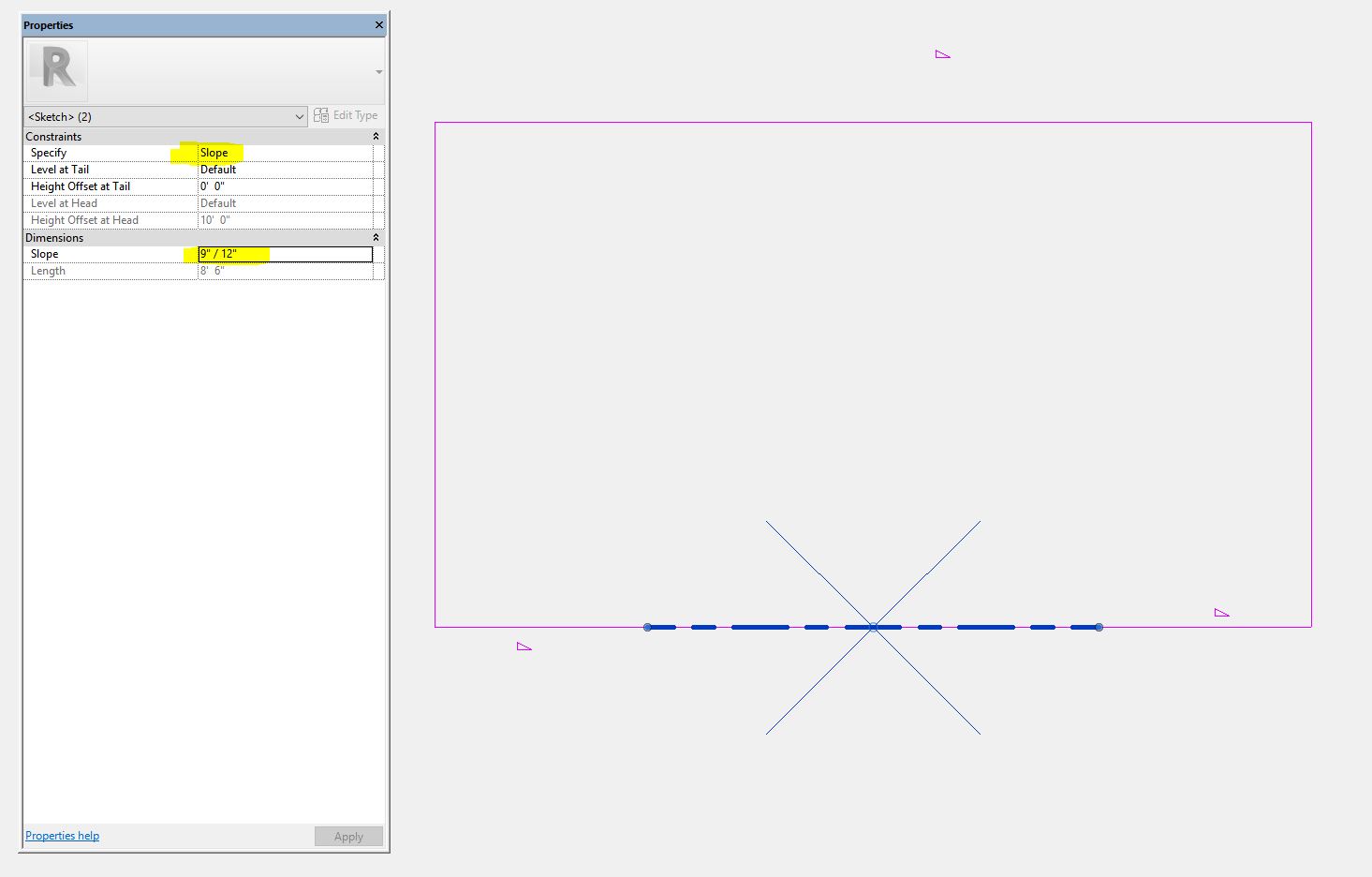

Split the segment where false gable. Do not apply slope to that segment (pic1). Add slope arrows and adjust their slope (pic 2).

That worked! Thank you for your help!
