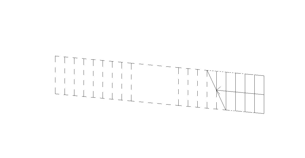

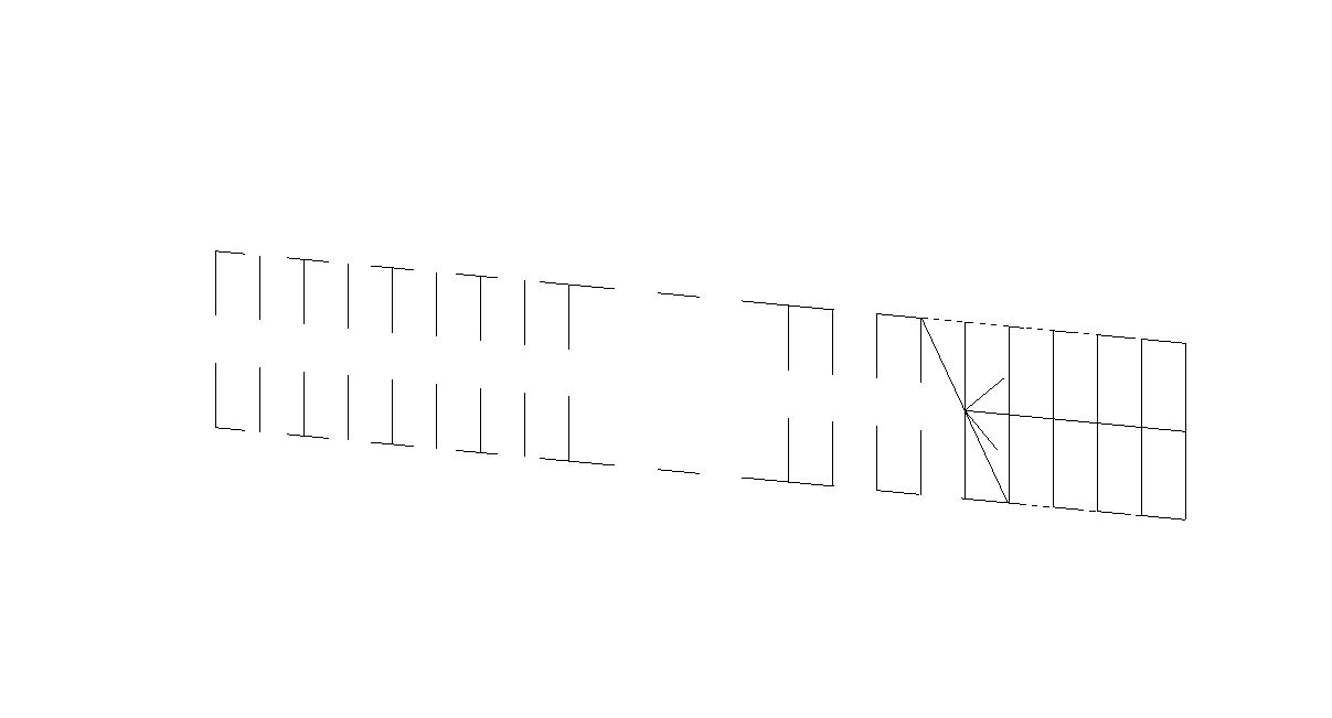

this problem has been bugging me for weeks now and I can't seem to find a solution for it.
I'd like to know if there's any way to prevent line types to scale if I change the scale in a plan view. For example, I'd like to have the "above" dashed stair lines to show in the 1:200 view exactly the same way as they're displayed in the 1:100 view. I hope my question is clear enough, english is not my first language.
Thanks in advance
PS: first image is 1:200, second image is 1:100

Tue, Jun 27, 2017 at 6:12:14 AM | Line type scaling issue
Revit is unlike CAD.  In Revit, linescale is always adjusted so that in paperspace, the lines always look the same.   In otherwords, if the linetype has a 1/8" gap in paperspace (printing), it will have a 1/8" space no matter what the view scale is.
