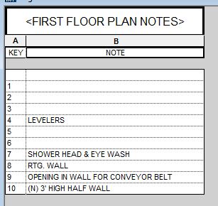

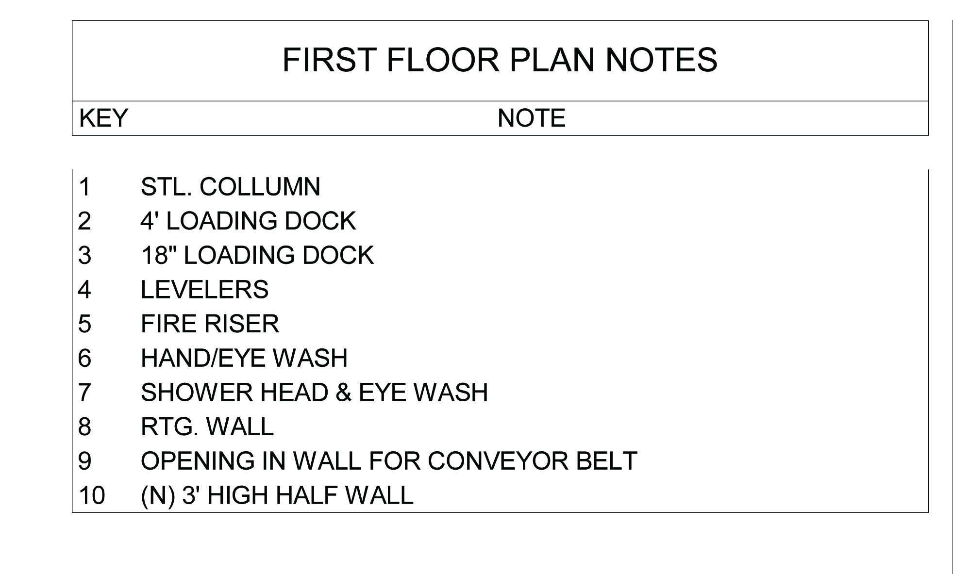

I can't get my legend to look right. first of all, I dont need the row that says "key" / "note" but I can't get rid of that row. Second, there is a space between the "key" /"note" row and the actual note area, as you can see, my boarder won't connect there because of this space. I have no idea how to get rid of it. I just want one big bold box around the whole thing, and a thin line between "first floor plan notes" and the begining of the actual notes. This shouldn't be difficult to acheive. lol. first photo is what it looks like printed, and second is what it looks like in revit.

Hi ya,
Regarding the schedule you are asking about:1) Re" I dont need the row that says "key" / "note" but I can't get rid of that row" Highlight schedule in project browser by clicking it once, go to properties and at the bottom you will see appearance. Click it. In the appearance window, untick the box that says Show Headers.. Click ok.
2) Re" Second, there is a space between the "key" /"note" row and the actual note area, as you can see, my boarder won't connect there because of this space. I have no idea how to get rid of it. I just want one big bold box around the whole thing, and a thin line between "first floor plan notes" and the begining of the actual notes. "  Highlight schedule in project browser by clicking it once, go to properties and at the bottom you will see appearance. Click it. In the appearance window, untick the box that says Blank Row before data. Click ok.
Hope that helps.

Thank you SO much!! That was as easy as it should be haha.
