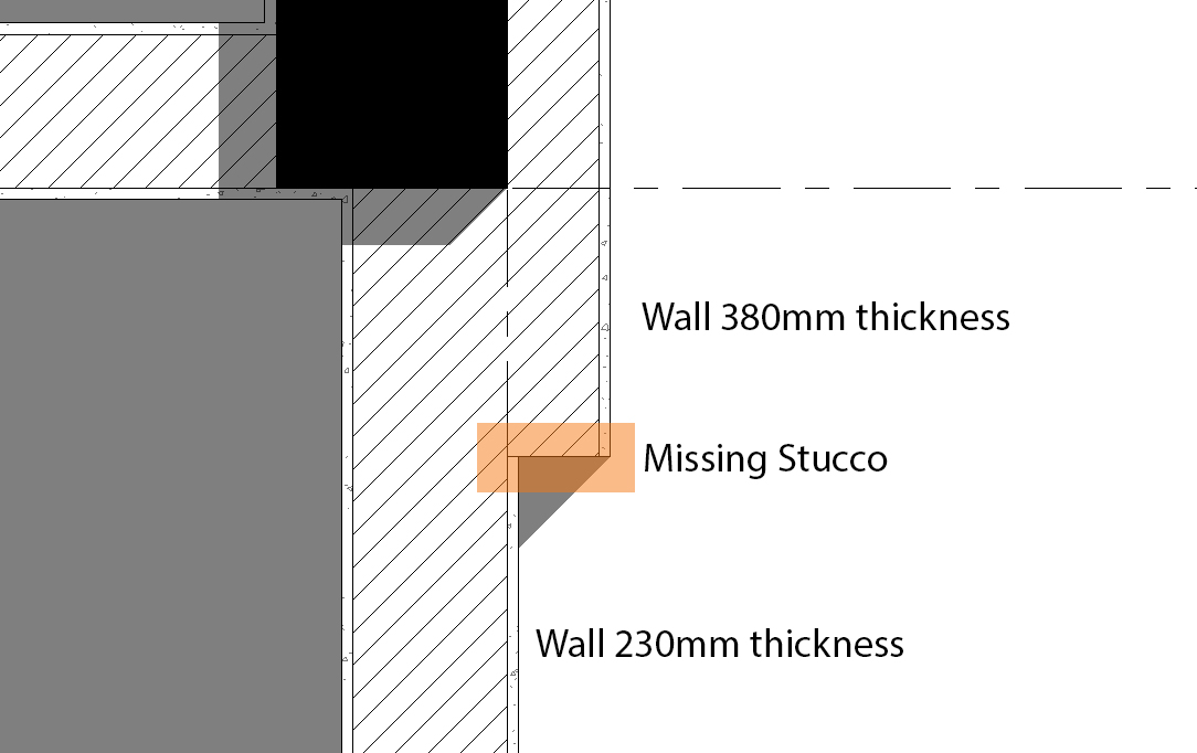

Hi all.
Follow attached file.
I can not solve this. I need some help.
Thanks.

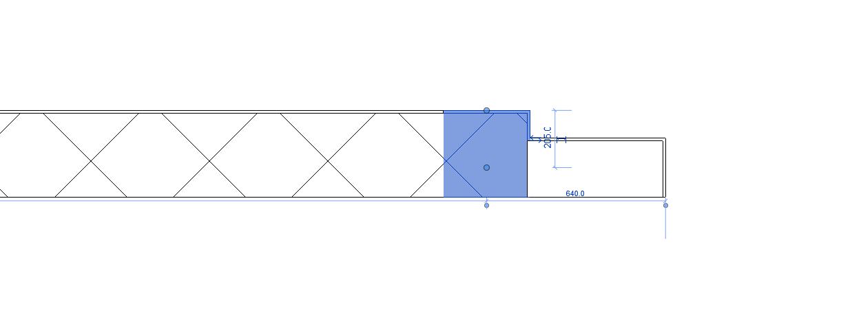

if that's a plan what i have done is that i added a small perpendicular wall of the bigger type ( Attachment 1 ) and make sure the wrapping at end is working ( Attachment 2 )

I was try any kind of wrap... Nothing happen.
Wed, Jun 21, 2017 at 3:28:32 PM | Floor plan - Wall missing stucco
The standard wrap will not happen here because the wall is joined.  For 3D, paint that exposed end with gyp, for 2D Plans, edit cut profile.
