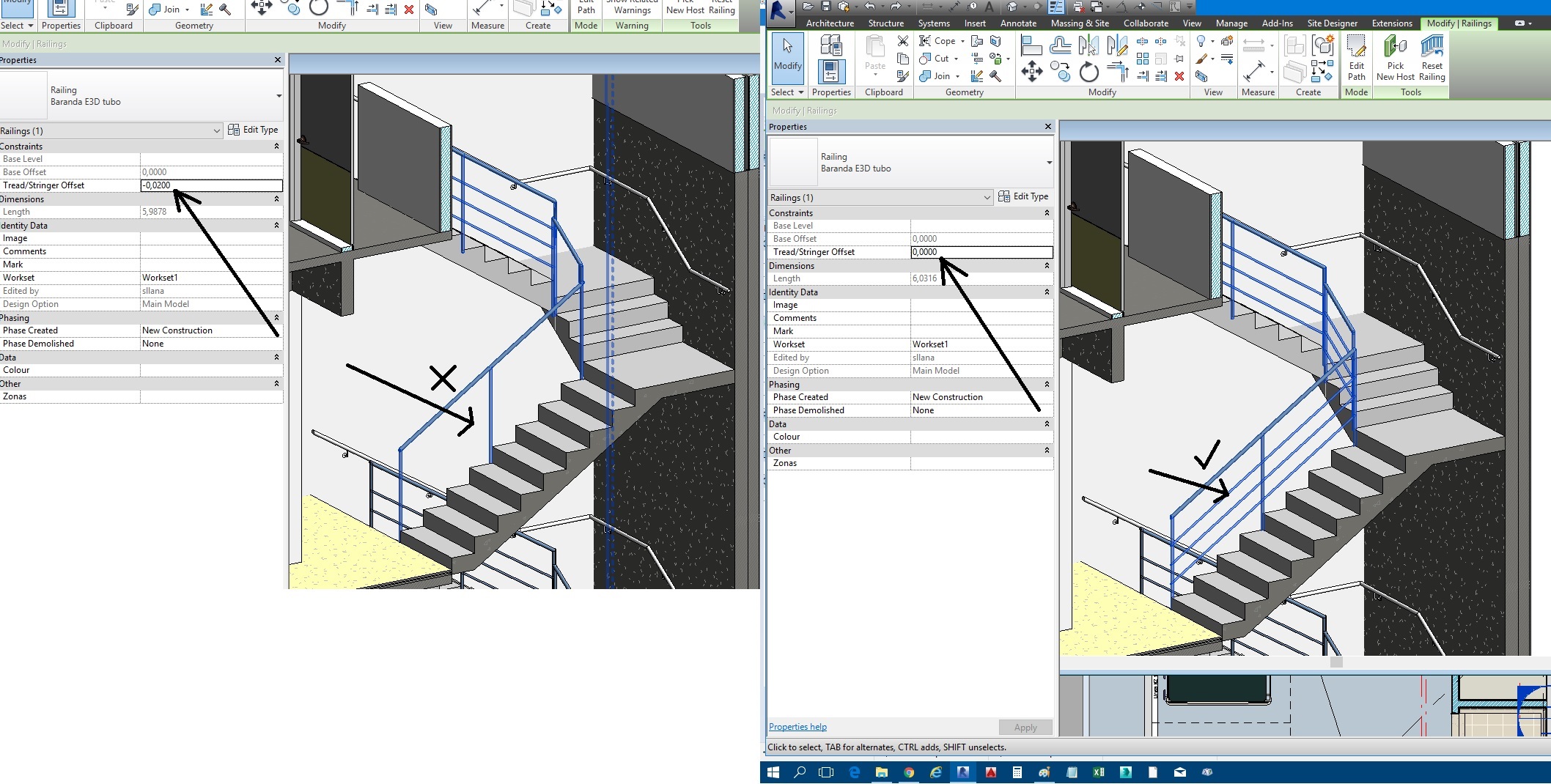

Hi everyone, sometimes, when i give a negative offset to one of my railings, some of the rails disapear. Any ideas why?
Thank you all.
It is revit 2016

I can’t recreate your issue here. Any chance you could upload your stair and rail so we can take a look?

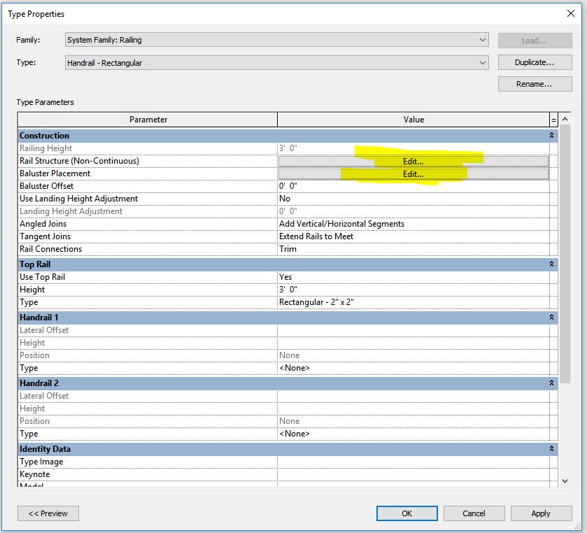

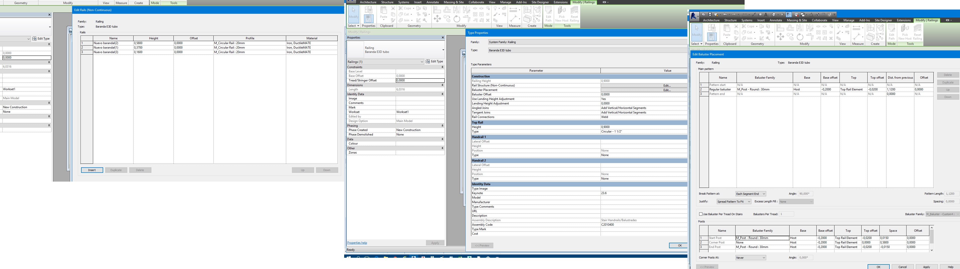

Can you at least post the screen shots of the rail properties (as shown on picture) and two additional as marked on the pic.?

All looks fine to me. Considering the inconsistent behavior, I must say it's a glitch/corrupted file. Perhaps you could submit the file to Autodesk for them to repair it.
