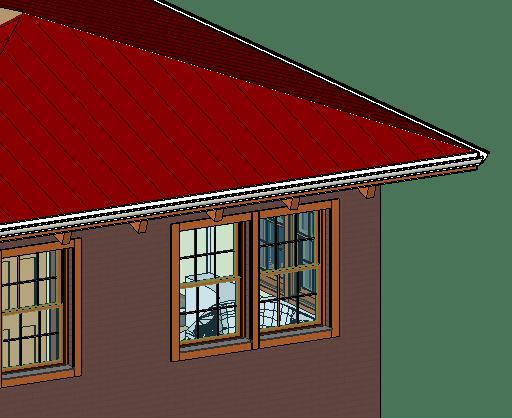

I need to find a window that would go into a stud/brick wall 9-1/2" thick with brick sill and soldier above. I am not sure on how to go about it. I have only put windows in stud walls before. I also need to do this for my garage doors as well. Should I put in a window with no trim and and make the sill and soldier around it? I am also using 7.1 for this project. I did not move up to 9 since I am almost finished with it. Thanks for your comments

yOU CAN EITHER CREATE A FAMILY, USING ONE OF THE EXISTING CILL OR LINTOL FAMILIES AND EDIT. OR CREATE A FAMILY WITHIN THE PROJECT BY DRAWING THE CILLS ON ELEVATION AND GIVING A DEPTH, THEN APPLYING A BRICK SOLDIER MATERIAL. (APOLOGIES FOR CAPS BEING ON LOL)
