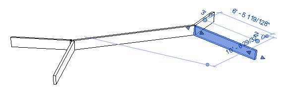

Hi All,
When I create beams o a hip roof they don't get attached.
Thanks!

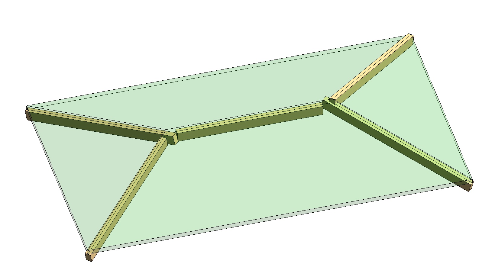

You should be able to make this work by using the different beam grips. See image . . .
Hip Roof Issue
