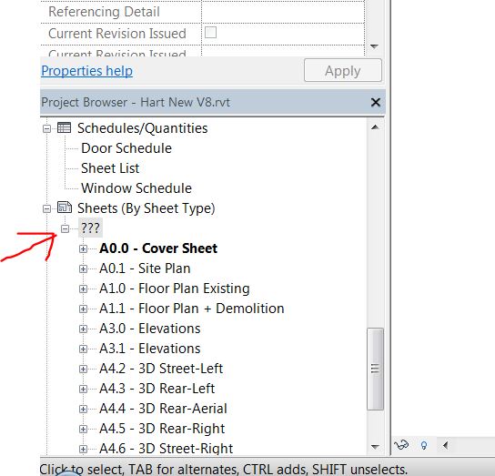

Can someone direct me to a link or something that would explain this? see picture. its the small ??? at the top of my sheet list.
Not sure How I accomplished getting this. I think this file is from another and I might have repourposed it, but not sure.
Thanks!

You most likelly have an empty field on all those sheets properties, that help sorting them in the browser. Othwerwise it would be grouped into whatever you specify: for instalce Plans, Sections, Elevations. Look at the sorting rules in the browser.

Try to right click the “Sheets (By Sheet Type)”, then click the “Browser Organization”, a new window will pop up. That might give you some hints.
